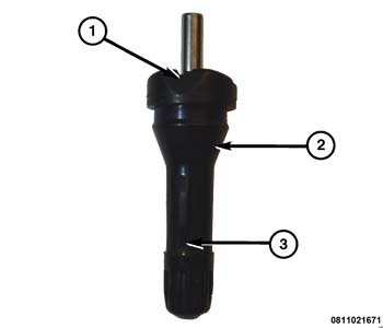

When installing a new valve stem (2), do not install it with the sensor (3) attached. If it is a new sensor, separate the valve stem from the sensor first then install the components separately.
NOTE:
Replace the valve stem (2) assembly with each tire change or when the tire is removed from the wheel.
1. Wipe the area clean around sensor/valve stem mounting hole in wheel. Make sure surface of wheel is not damaged.
pic 2
NOTE:
When installing a new valve stem (2), water or water/soap solution should be used for proper installation into the wheel.

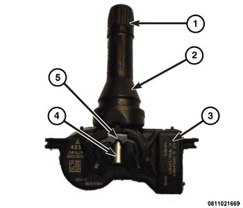

2. Position the valve stem (2) into the wheel mounting hole with the rib (3) at the 12 o'clock position to the wheel, then pull through to seat with a standard valve stem installation tool.
pic 3

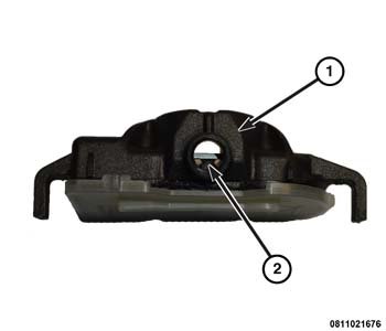

3. Install the sensor (1) onto the valve stem by aligning the rib in the sensor (2) to the valve stem.

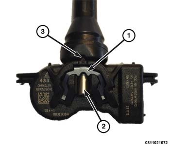

NOTE:
The valve stem (3) has 2 notches (1,2) on the locking pin where the sensor can be installed depending on the thickness of the rim on the wheel. Refer to steps 4 and 5 for installation on both types of wheels. The sensor is properly installed if the sensor is as close as possible to the valve and the locking pin is visible past the spring clip.

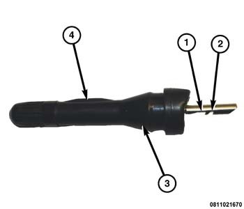

4. The first notch is for a wheel with a thick rim, push down on the spring clip (1) using a small screwdriver and slide the sensor up until it stops against the bottom part of the valve. Gently pull down to verify the spring clip has engaged.
NOTE:
The locking pin (2) will be visible sightly after installed.

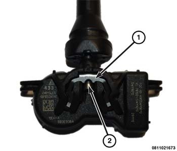

5. The second notch is for a wheel with a thin rim, push down the spring clip (1) using a small screwdriver and slide the sensor up until it stops against the bottom part of the valve. Gently pull down to verify the spring clip has engaged.
NOTE:
The locking pin (2) will be highly visible after installed and orientation notch (3) seated.
