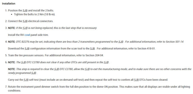

Walmart put 4 new TPMS sensors in my truck listed above, along with the new tires. Now the dome lights flash we engine is running. The tire pressure monitoring sensor warning light is on the dash. I have successfully reset/relearned the sensors via hazard lights method (horn honks to move to next tire and at the end it says Training Complete with no additional horn sounds). Filled tires back up with air and have driven truck. Yet the dome lights flash, and warning light is on dash. Your help is appreciated.

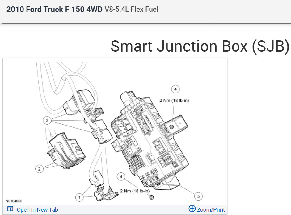

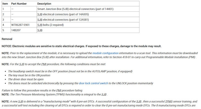

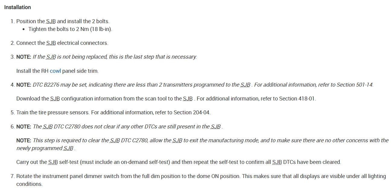

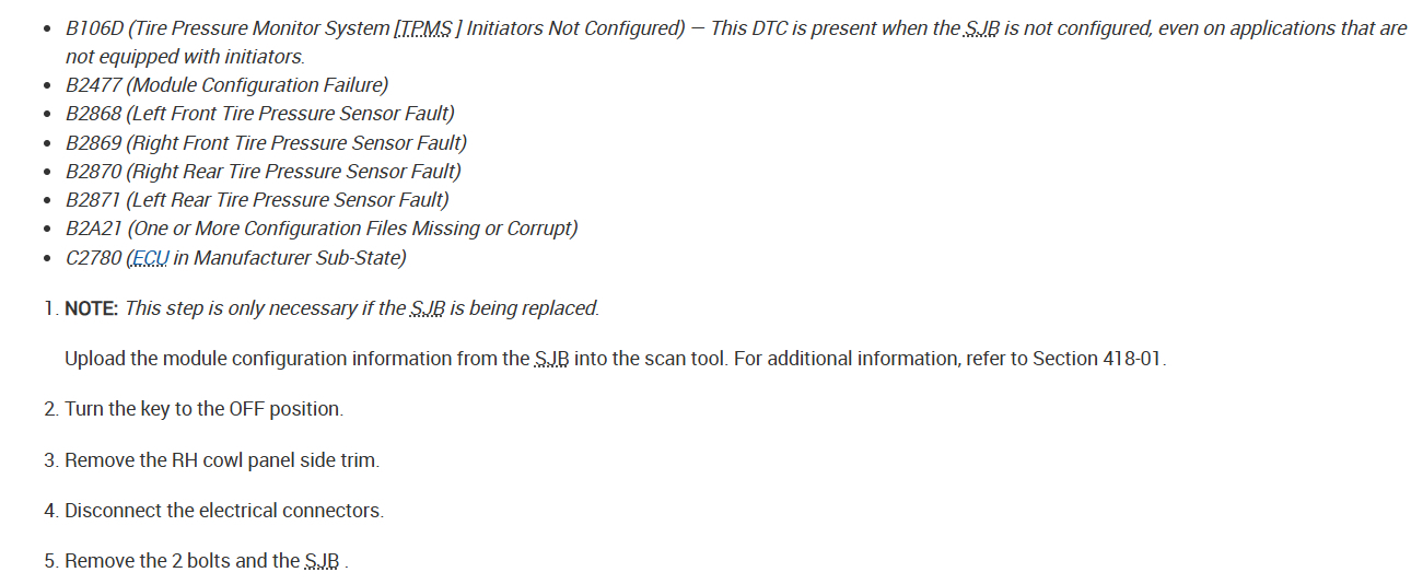

I see that the smart junction box, (GEM) runs both these systems which if Walmart let the battery get low and then boosted it could have blown it out. I would feel better about getting a code though before we jump to that conclusion. Here is how to change out the SJB in case you need it. Check out the images (below). Let us know what you find.
