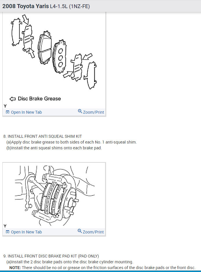

I've had to replace the front brake pads on my '08 Toyota Yaris - the old ones were completely worn out and squealing at every press of the pedal.
Do I need to bleed the brake lines when I replace the brake pads?
Oct 19, 2010 at 11:18 AM
SQM
  • 6,383 POSTS

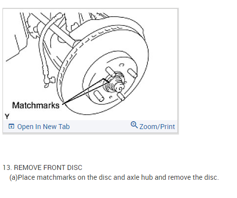

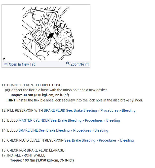

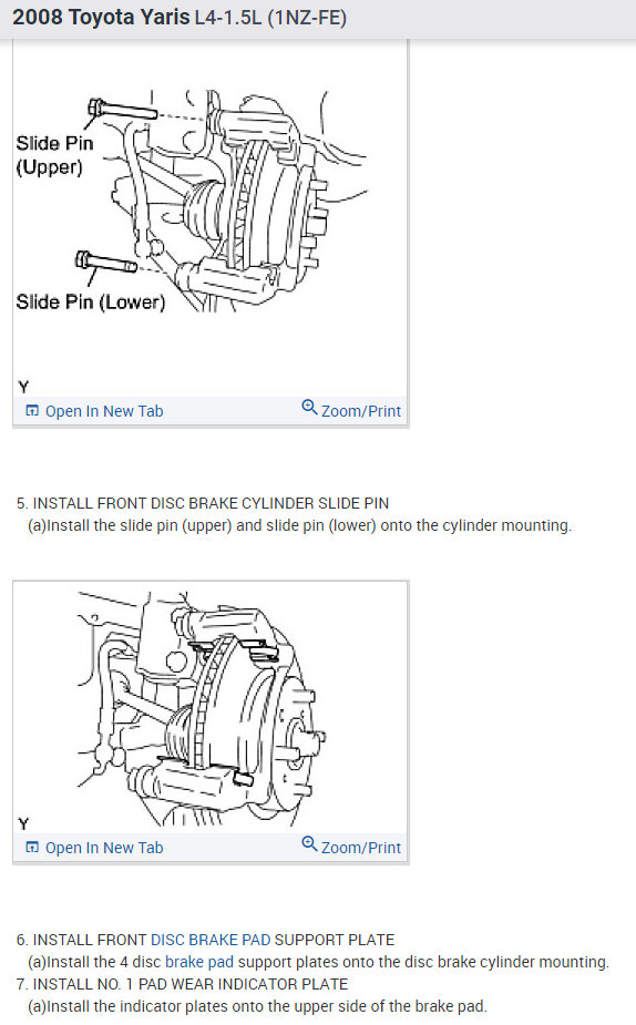

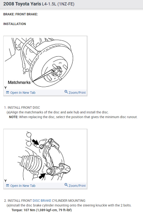

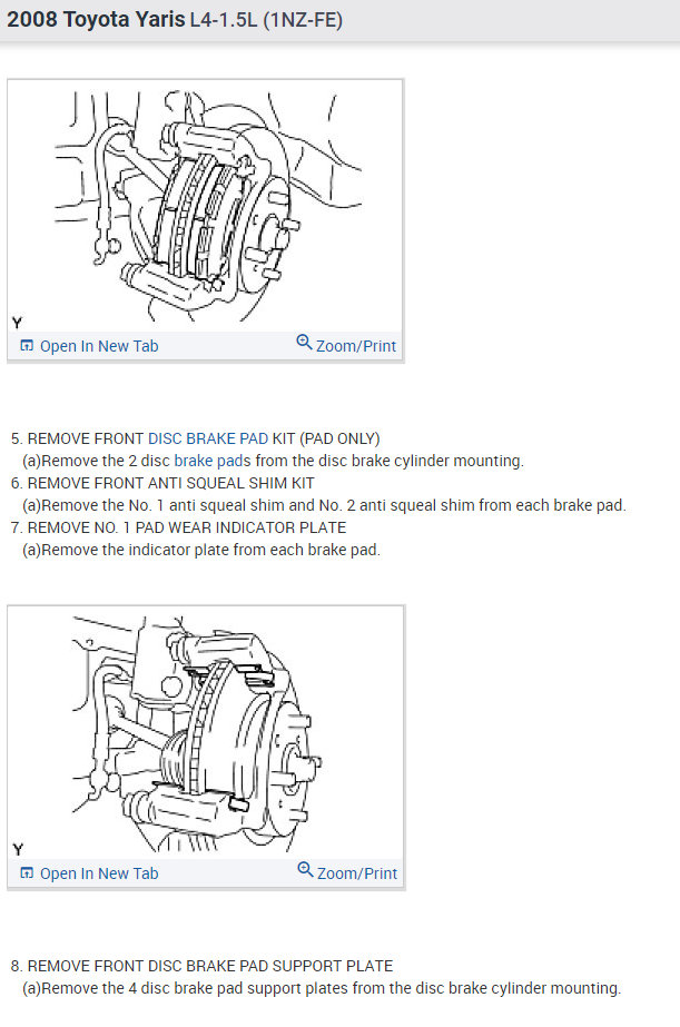

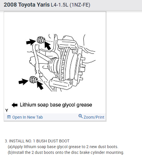

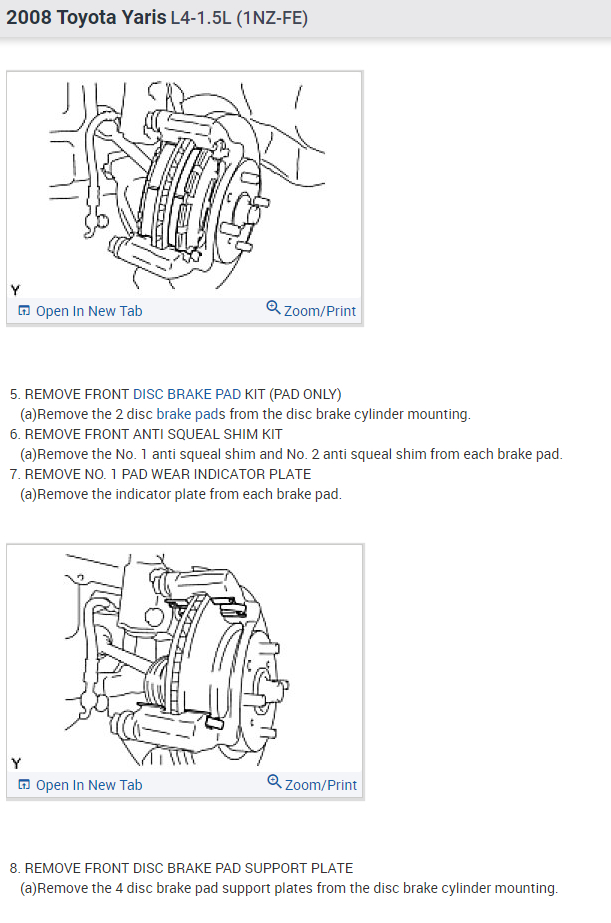

Unless you have spongy brake pedal issue, you do not have to bleed the brake after replacing the pads. When you replace the pad you do not have to disconnect the brake lines, and you will not get any air in the system, so no need to bleed.
Also if the pads have been squealing of sometimes, it can wear the rotor unevenly. So you need to inspect the rotors as well and replace if they are below specifications.
You might find this article helpful:
