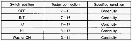

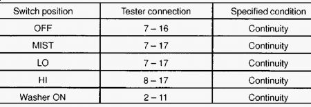

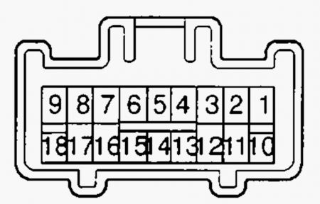

Test the multifunction switch for continuity this way, one chart is for system with mist and one is for no mist.
https://images.2carpros.com/forum/automotive_pictures/62217_Tundraa_1.jpg
https://images.2carpros.com/forum/automotive_pictures/62217_tundramist_1.jpg
https://images.2carpros.com/forum/automotive_pictures/62217_tundrab_1.jpg
If switch is good, replace motor.
