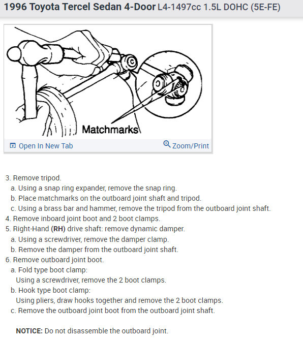

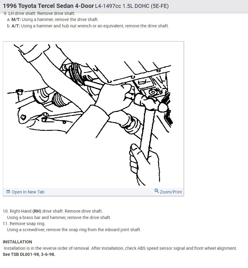

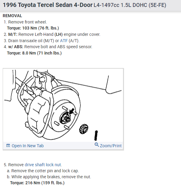

How can you remove the c-clip off the left CV axle ?
Jun 8, 2010 at 2:51 PM
SQM
  • 6,383 POSTS

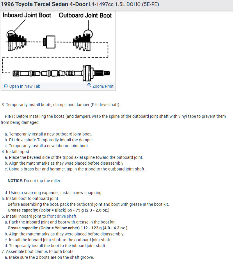

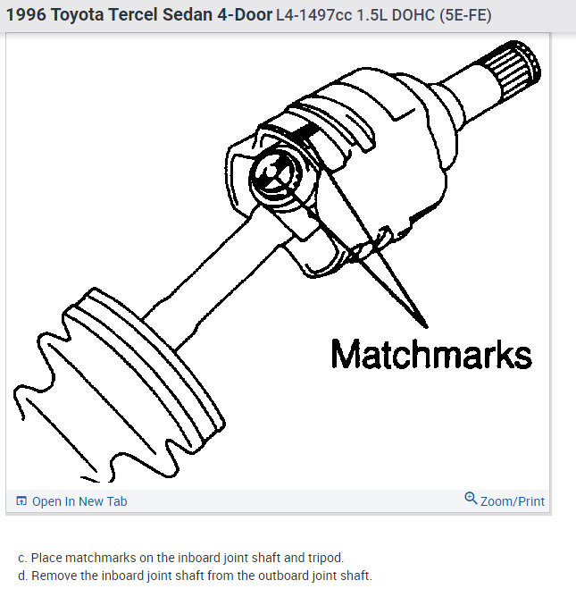

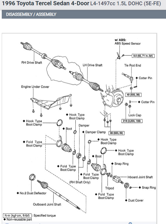

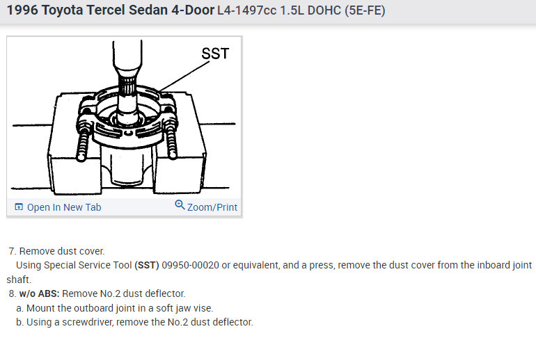

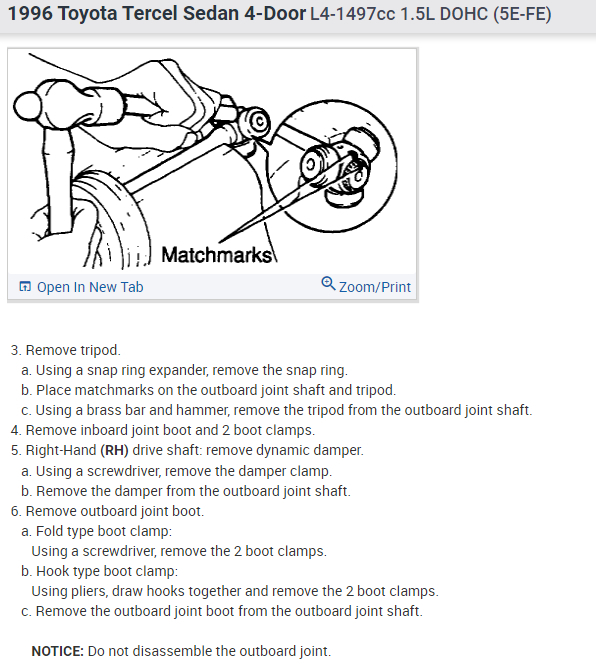

On this CV axle there should be a snap ring at the end. To remove the snap ring you will have to use a snap ring plier to safely remove that ring.
Without the proper tool it will be difficult to remove.

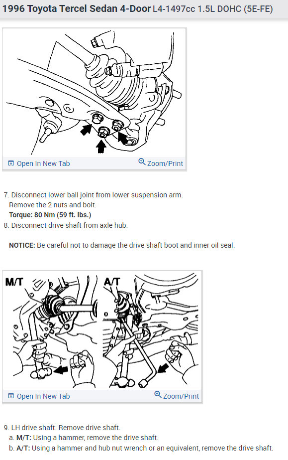

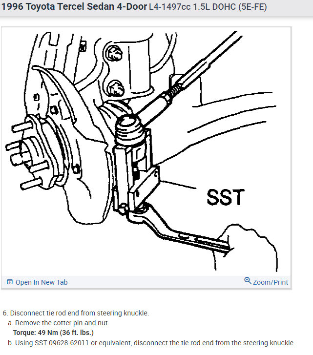

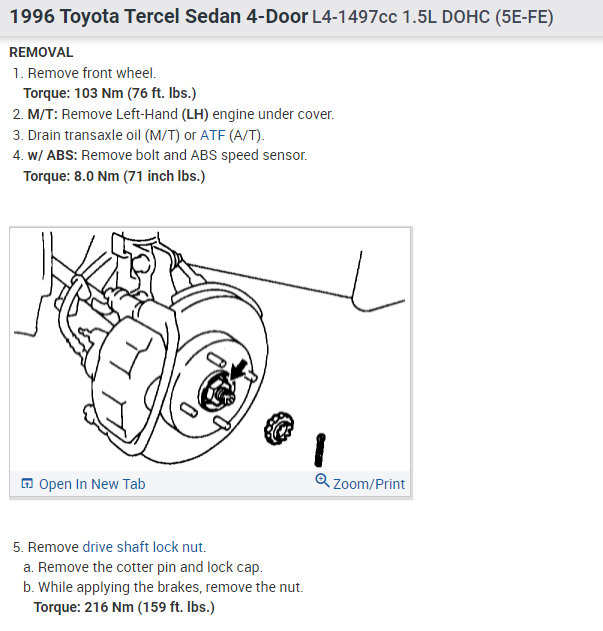

There is also a cotter pin that you will have to remove before taking off the axle nut to get to the CV axle.
Here is a helpful article:
https://www.2carpros.com/articles/replace-cv-axle

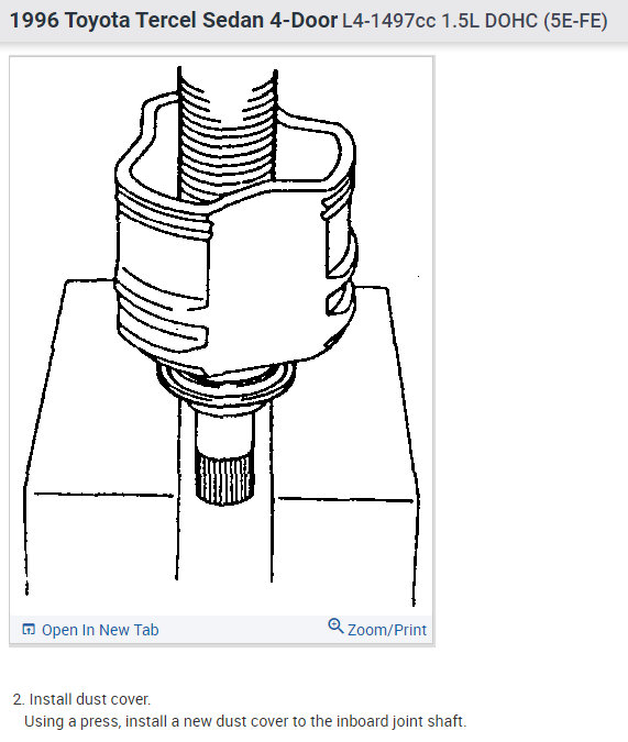

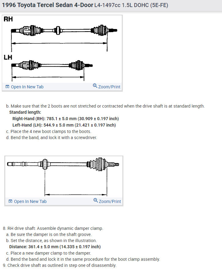

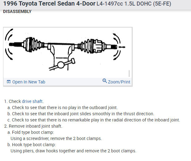

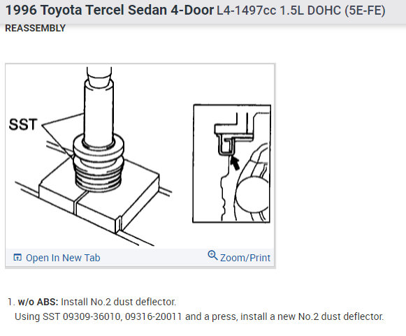

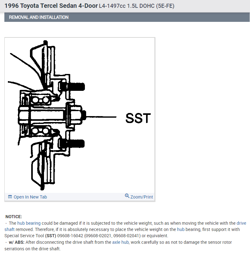

I have attached the replacement procedure as well as assembly and disassembly procedure for your reference.
