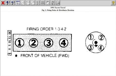

i recently replaced an exhaust valve on my 1991 toyota tercel. when i put everything back together i tried to check the timing with a timing gun, but i was unable to find any information in the book or online about what the timing should be. can you help?

Jump check connector TE-1 to E-1 now check the ignition timing it should read 10 degrees before top dead center, if not adjust it, lock down the distributor and your done.
https://images.2carpros.com/forum/automotive_pictures/12900_timing_1.jpg
