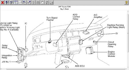

Its gonna be tough with this one -look below is it one of these fuse
https://images.2carpros.com/forum/automotive_pictures/12900_fuse_block_4.jpg
https://images.2carpros.com/forum/automotive_pictures/12900_fuse_block_2_1.jpg
Jan 22, 2009 at 9:46 AM
YOURMOM
Hard to read, but I couldn't find one at all on the i-net! The bottom diagram should represent the box under the hood and it would be the fuse labled EFI.
Jan 22, 2009 at 9:52 AM
  • 75,992 POSTS
I want you to remove the circuit opening relay-replace the EFI fuse-did it blow
https://images.2carpros.com/forum/automotive_pictures/12900_cor_2.jpg
Jan 22, 2009 at 9:58 AM
YOURMOM
Unfortunately, I had to leave the truck at work and the gate is locked up until early tomorrow morning. I can say that I did not mess with anything inside; I merely replaced the EFI fuse under the hood and it started right up, it went a 1/4 mile and blew again. Replaced it again, same result, but I'd made it back to work from lunch after the second time and thought it best to leave it there for now, lest I make the problem worse. I will certainly try your suggestion first thing tomorrow and post my results here. Thank you sooooo much!!!!!
