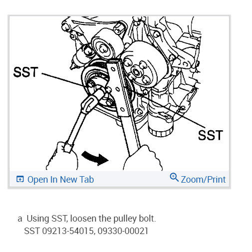

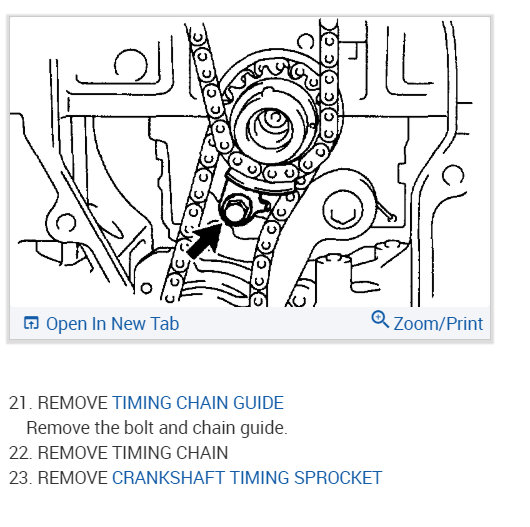

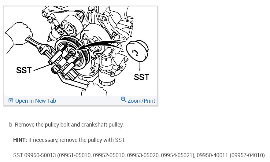

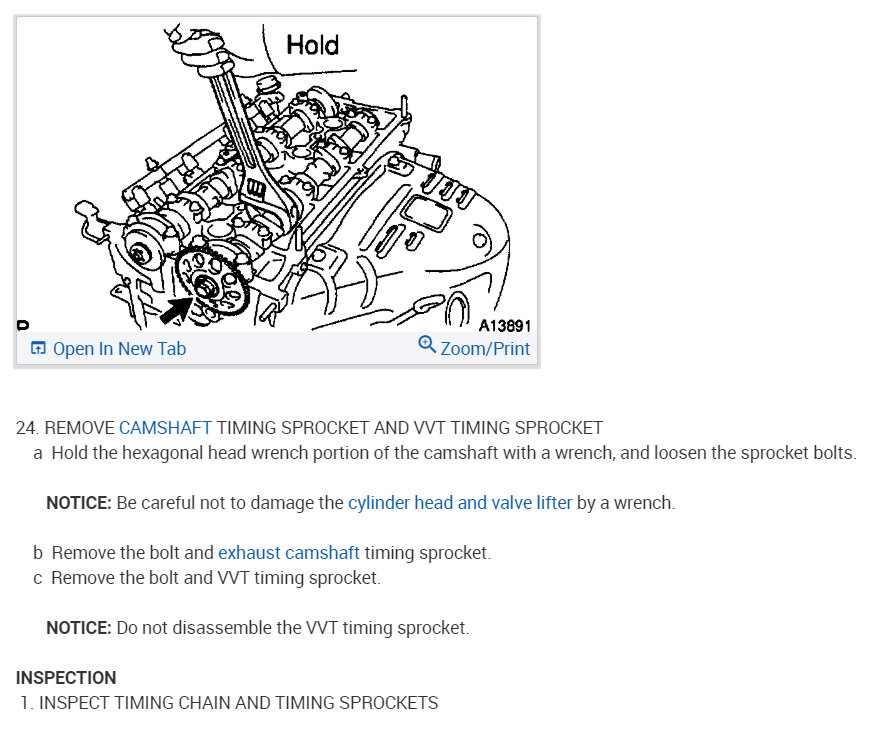

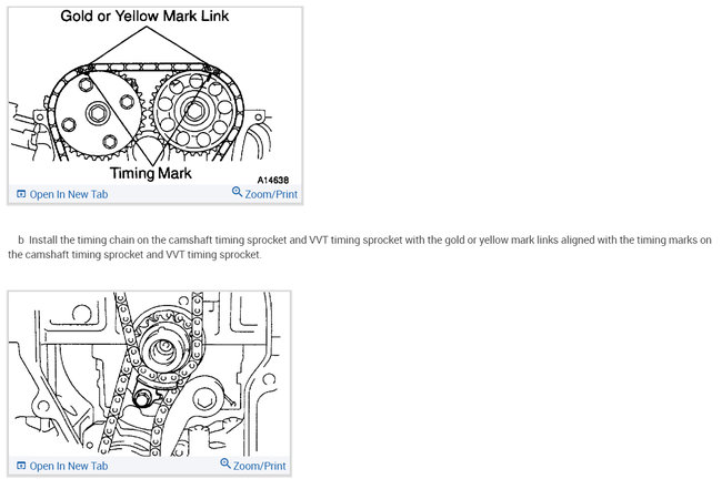

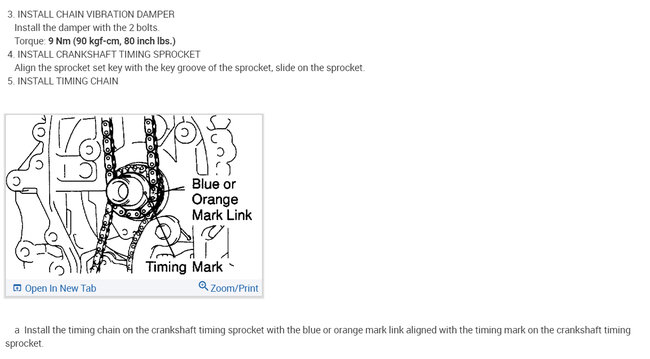

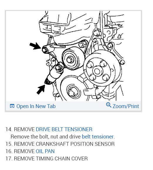

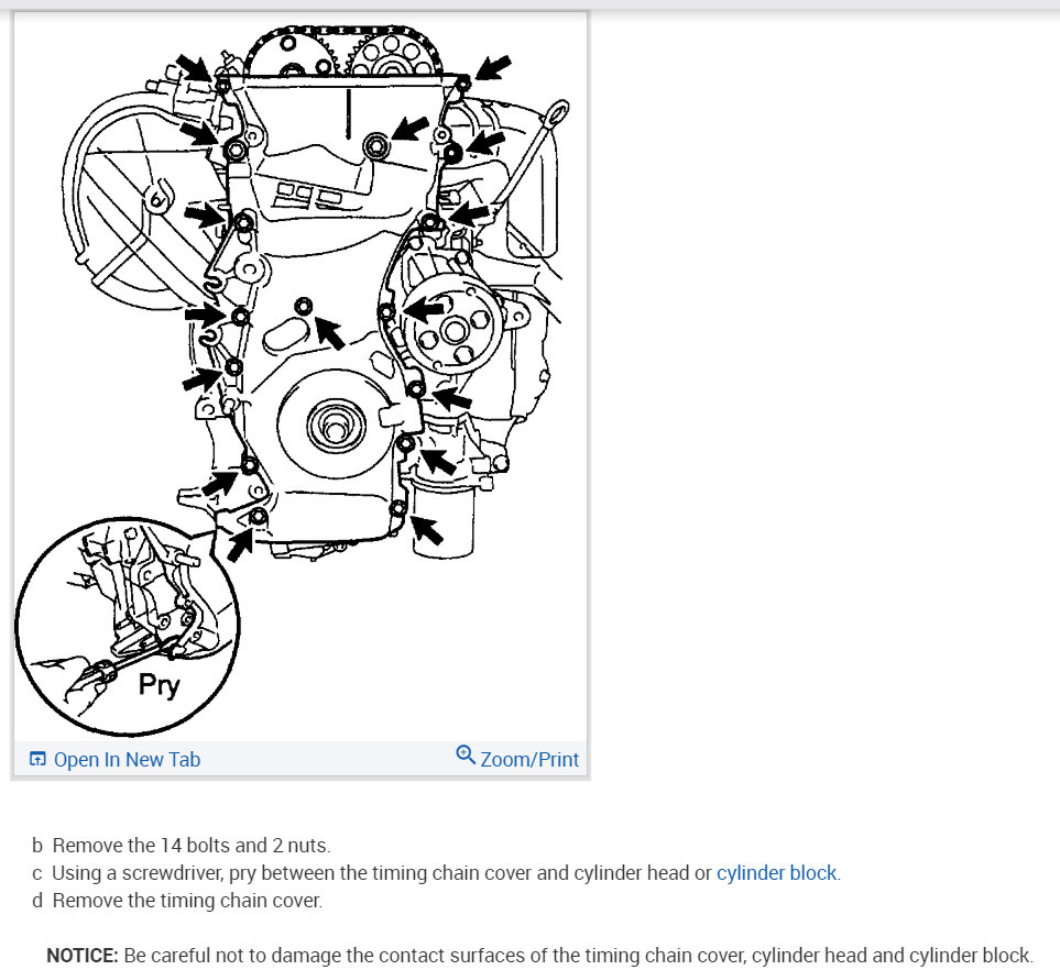

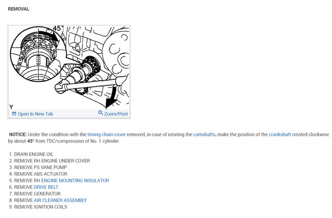

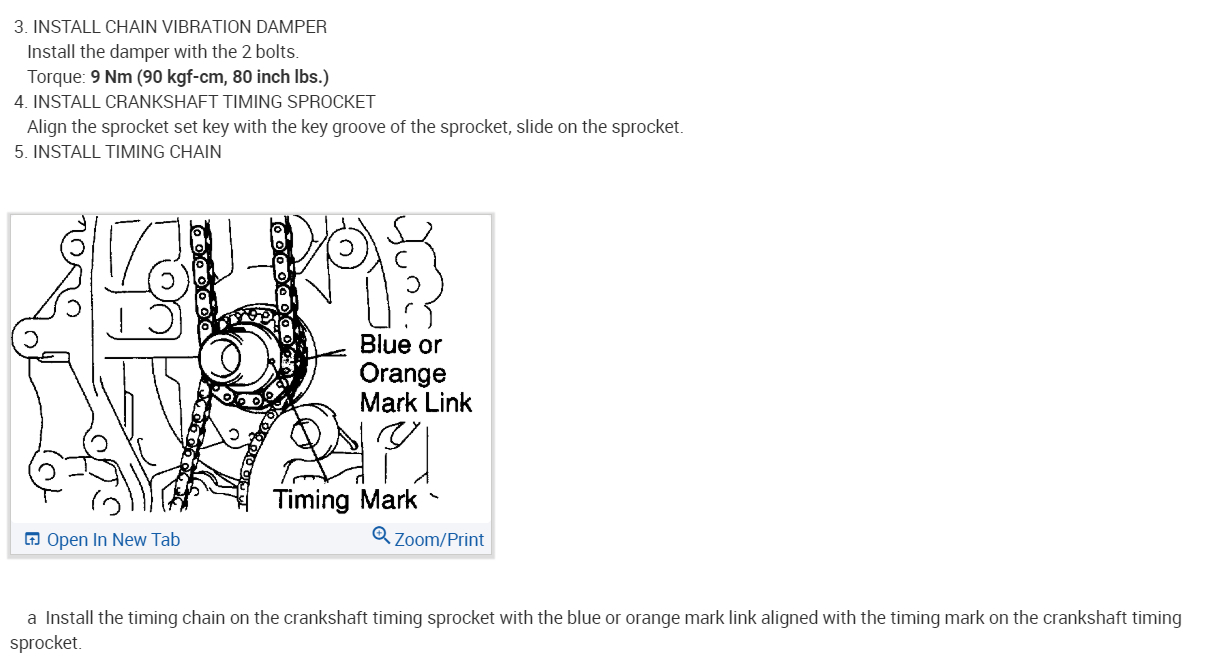

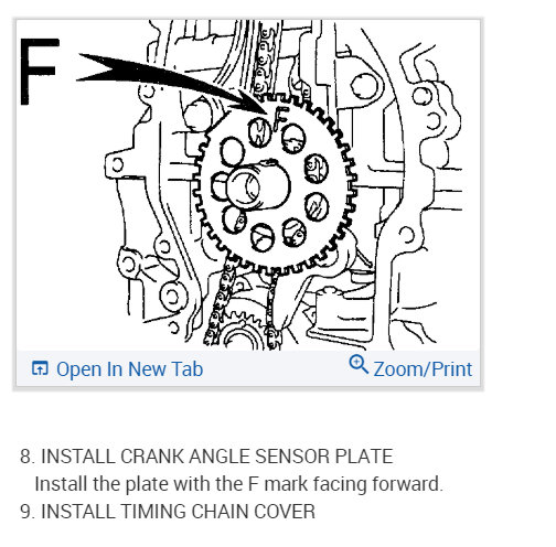

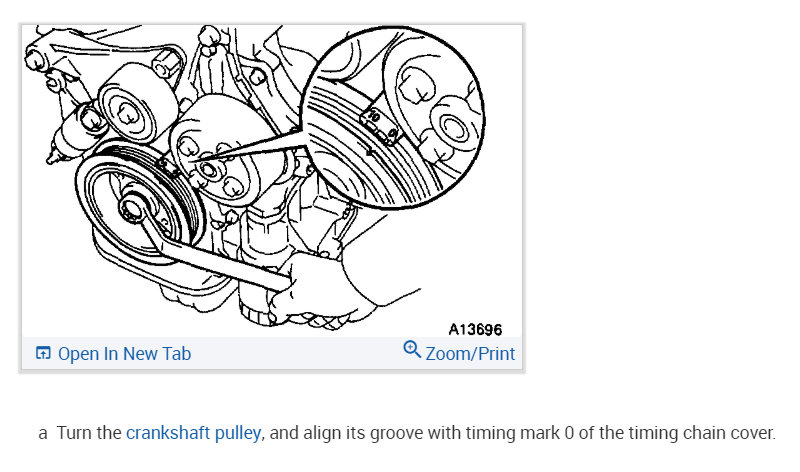

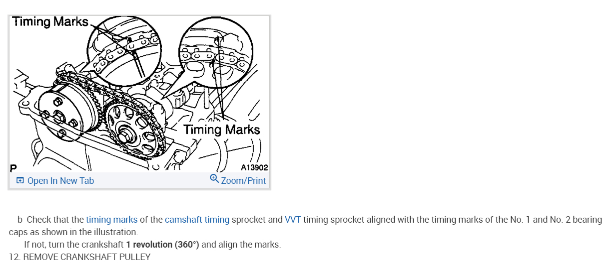

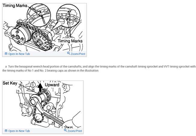

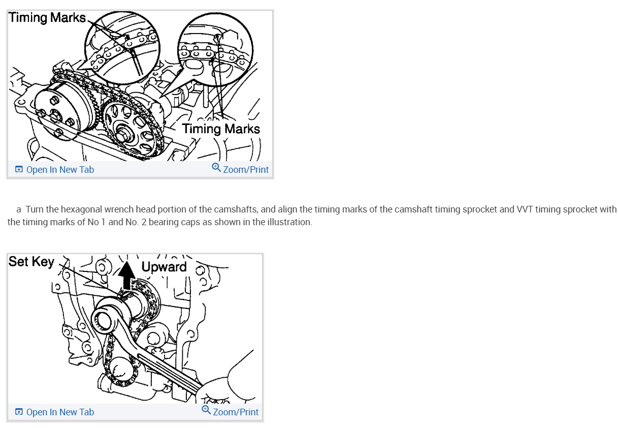

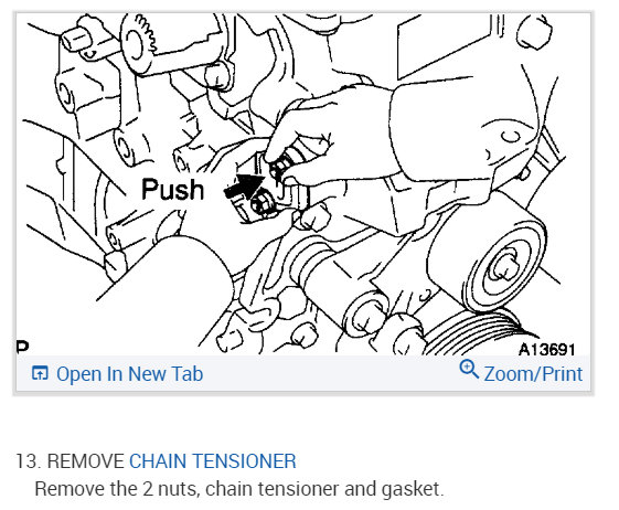

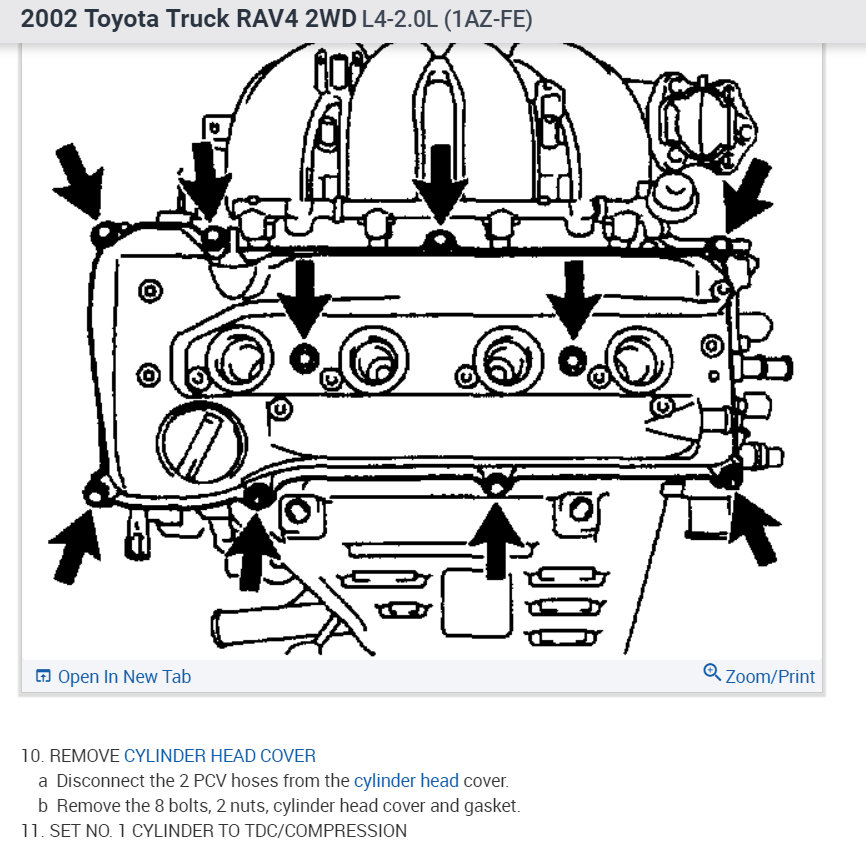

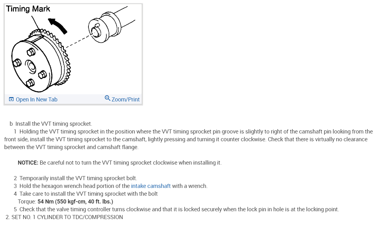

After changing the timing chain where can I see the center on which the camshaft should be placed?
Feb 10, 2010 at 12:33 PM
BLUELIGHTNIN6
  • 16,542 POSTS

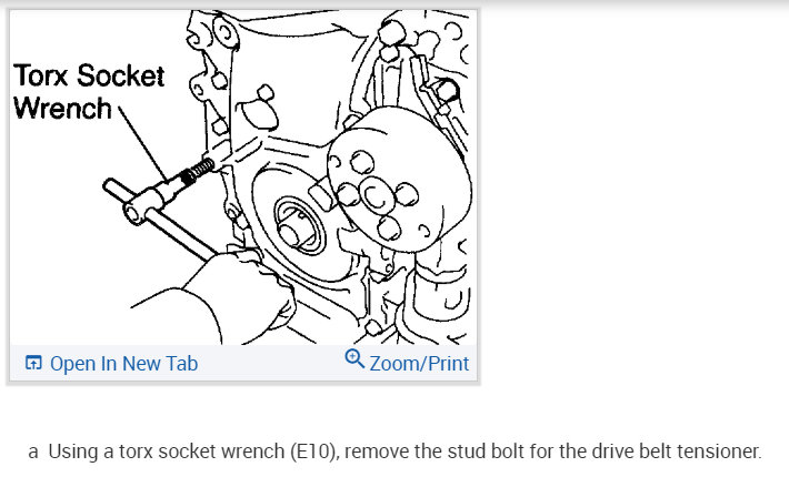

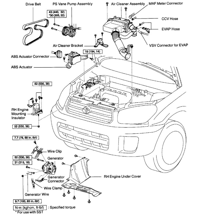

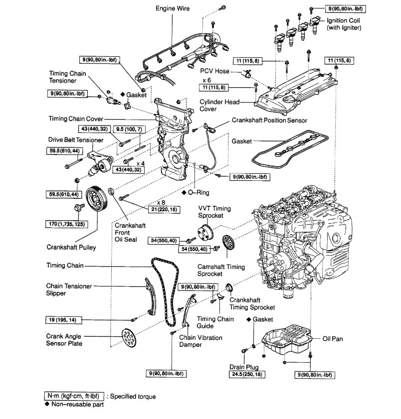

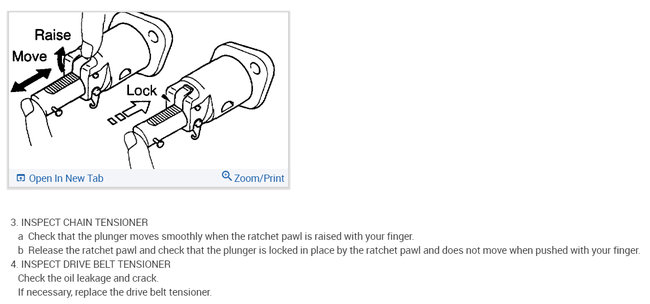

I founds the timing chain replacement instructions with the camshaft and timing chain marks. This has VVT so make sure you get the actuator on correctly. Check out the diagrams (Below). Please let us know if you need anything else to get the problem fixed.
