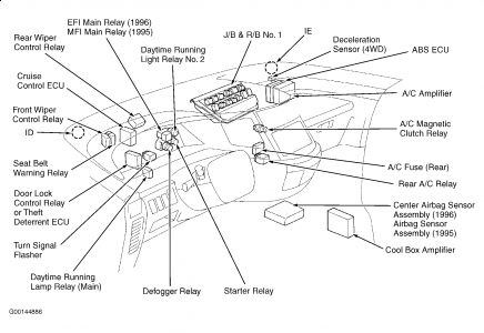

My 1996 toyota previa stalls out after exactly 1 min. I am able to start up right away. The EGR valve has been replaced (dealer) and the throttle sensor valve has been replaced (me) along with new wirers and coil.

Can you keep it running by holding the gas peddle
if so remove idle control valve and clean
clean throttle passages

My previa stalls out after exactly I min no matter if I hold down the gas peddle

We need to determine the cause is it fuel is it spark is a security system
hook it up to a fuel pressure set of gauges
and spark tester
start the engine and check what is missing causing it to stall at you
check EFI relays
https://www.2carpros.com/forum/automotive_pictures/99387_Graphic1_599.jpg
