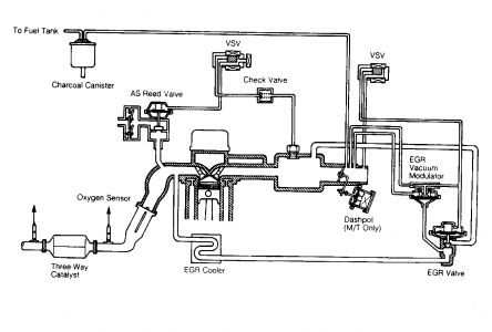

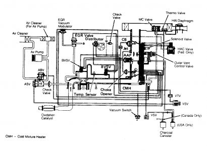

My truck runs great, but when I apply the brake pedal while stopped at a stop light the engine idles irratic, as if i'm stepping of the accelerator to begin a drag race, it reaches about 1800 rpm from idle 1100 rpm. but only while I apply brakes at a full stop.

Check for vacuum leak. Carburated motor
https://images.2carpros.com/forum/automotive_pictures/55316_22rcarbvacuum_1.jpg
Fuel-injected motor
https://images.2carpros.com/forum/automotive_pictures/55316_22rpfivacuum_1.jpg
