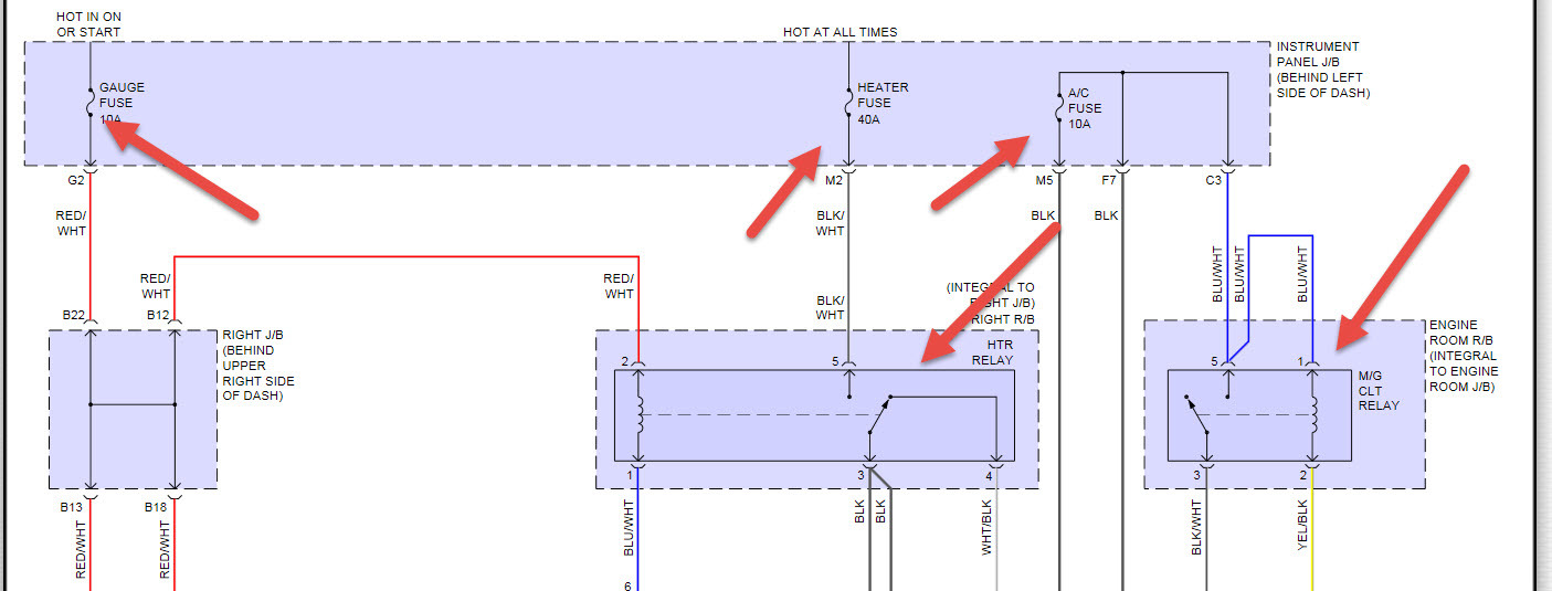

I changed the clutch in my 2004 Toyota Matrix this weekend, and low and behold the AC clutch will not engage now. I am not a complete noob so here is what all I know.
The 10 amp fuse under the dash is not blown. We actually tested all of the fuses under the dash and under the hood.
When you have the AC button pushed with the car running and fan on, the AC light comes on, the engine revs slightly to compensate for the AC clutch engaging, but the AC clutch does not engage.

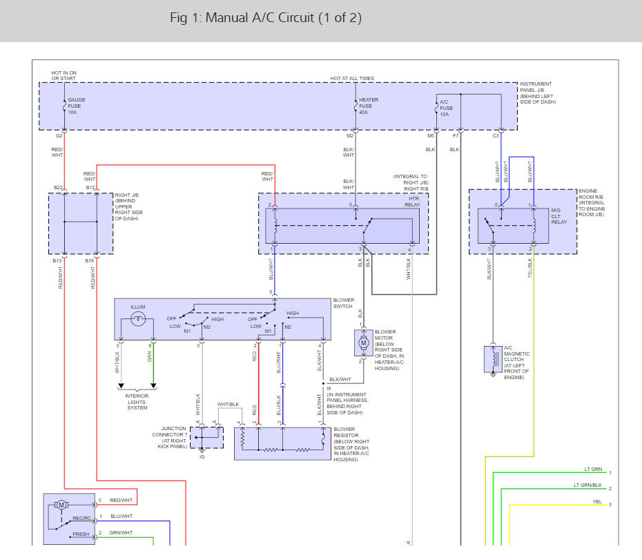

If you jumper the 4 post relay right under the hood the clutch will engage and build pressure until there is about 40 PSI on the low side. Also if you jumper + and - to opposite sides of the small little connectors on the relay you get continuity across the fat post on the relay and that good old relay functioning snap, so it seems ok.
The fans spin when the engine is running.

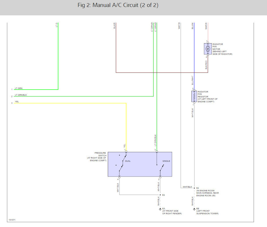

If you jumper the thing that is mounted in the high pressure line I can only assume is a pressure switch the cooling fan under the hood will come on, if you jumper it differently it will come on higher speed.
It really looks to me like it ought to work, there seems to be enough coolant in the AC system to trigger the low pressure switch. The clutch is connected otherwise jumpering it at the relay would not fire it. The switch in the cabin works otherwise the engine would not rev slightly when it is engaged and rev lower when it is not engaged.
The fan works. Is there any other sensor I am missing? Maybe it is somehow connected to a sensor to tell it when the engine is running?

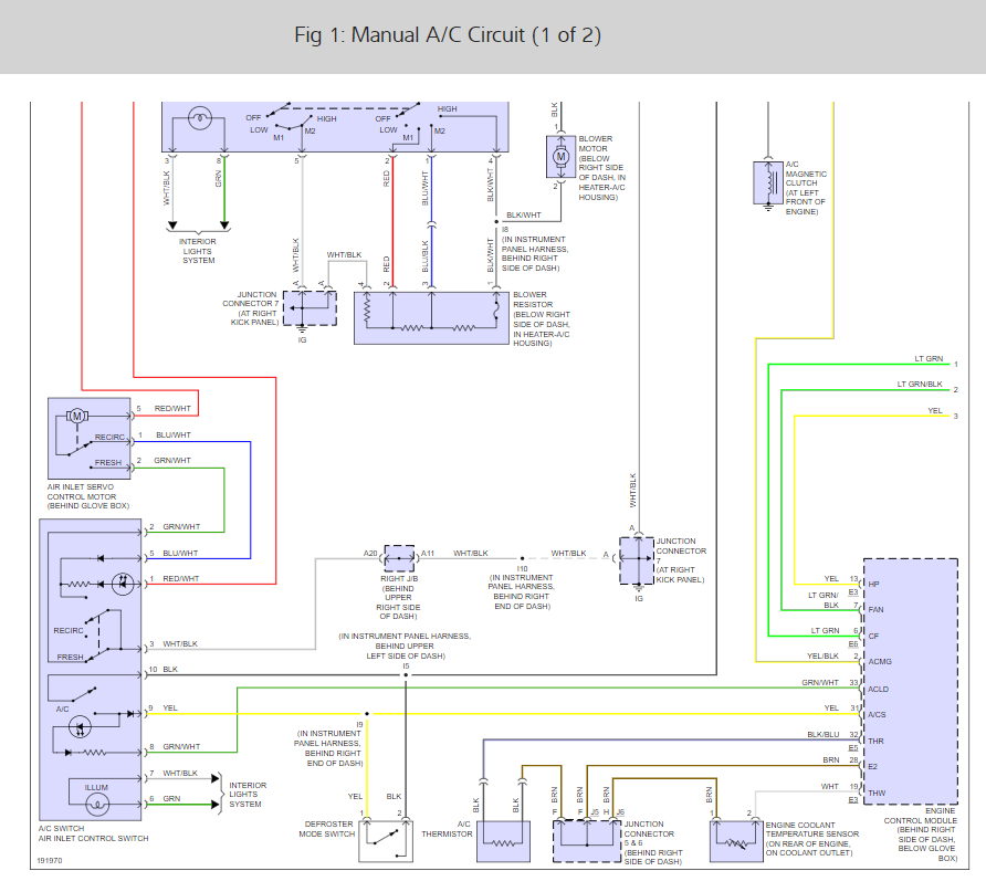

I know there will be more feedback than this , but you say you have 40 pounds of pressure. There is a difference between the pressure and actual freon. the freon level might be low enough to keep it from turning on. you can try to add more freon not the gas. There is instructions on the can telling you which way to have the can when filling. the unit. Go to how does it work section, it will give you more insights on it.

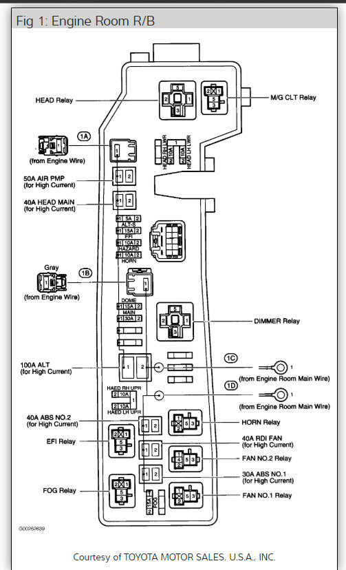

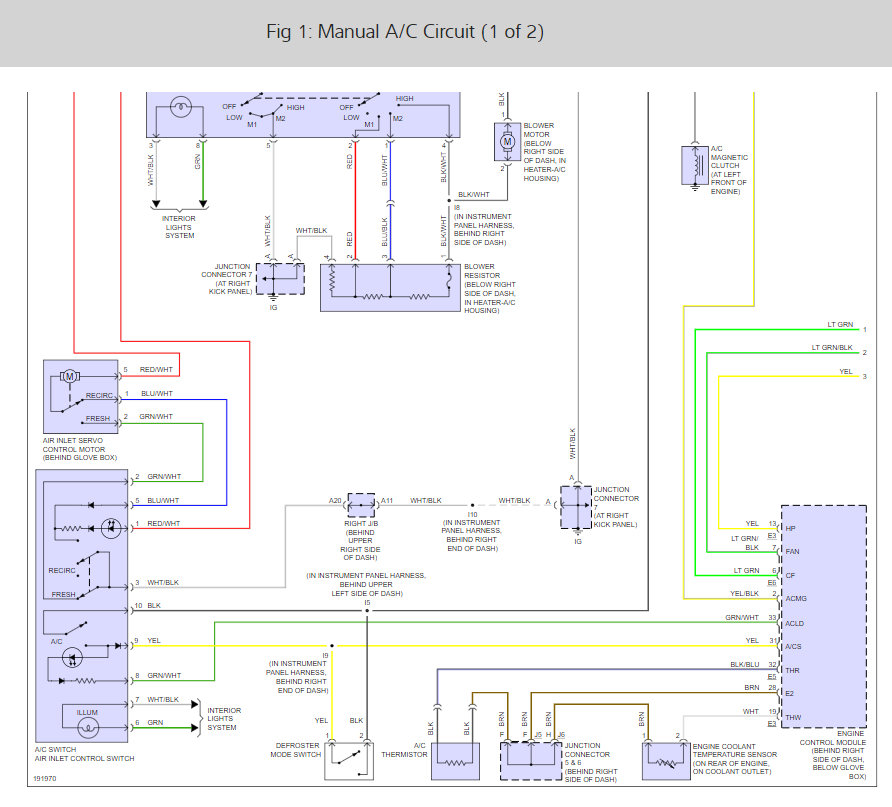

the compressor relay is called a M/G ctrl relay Here is the relay location and how to test it with the air conditioner wiring diagrams so you can see how it works.
Check out the diagrams (Below). Please let us know what you find. We are interested to see what it is.

Would I be well advised to try and jumper the low pressure switch to see if that makes a difference? There are 4 pins on it so I don't know which ones to jumper.

The system needs two things lubricant and freon. The freon is in a gas state until it goes to the compressor then changes to liquid. That what cools the car. You can have pressure without much freon. Most places will suck out the system then recharge it. You can try crossing it over on the low end. I am having problem getting into electrical diagrams have you checked out the how it works section on the left. It will explain some more on the system. There is also a section about problems.

For what it's worth it was the A/C relay. We tested it and the old one seemed to work, but perhaps our voltage was too high or something. I put another relay in it and it works like a champ.

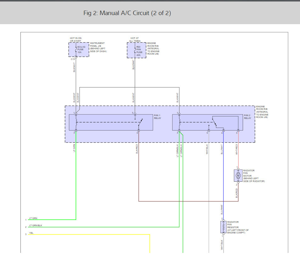

Check items in pic use a like relay in under hood fuse box to test relays or go to how to repair section on site here under electrical. If still doing it if relays ok then have it scanned for codes by a local pro
