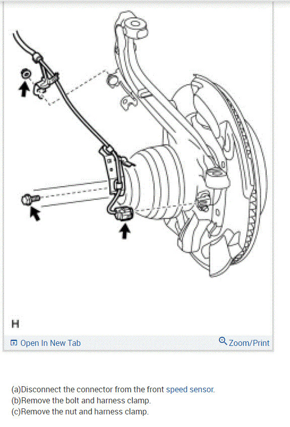

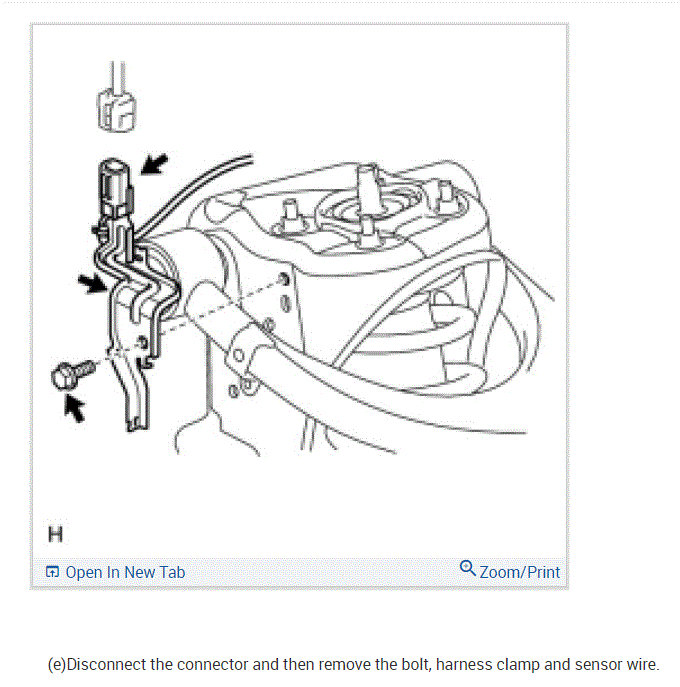

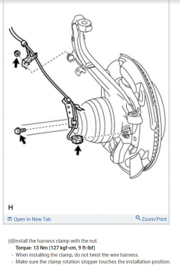

Problem with ABS light on telling me I need a right front wheel speed sensor. Please could you give me some advice as to what I should do from here? Thank you in advance.
Nov 12, 2018 at 9:52 PM
  • 110,194 POSTS

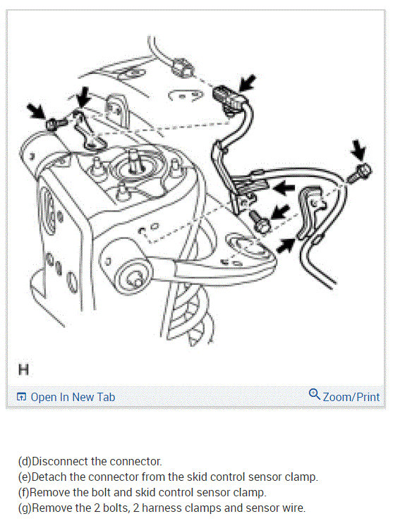

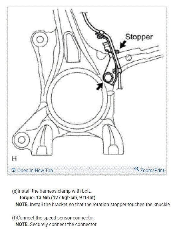

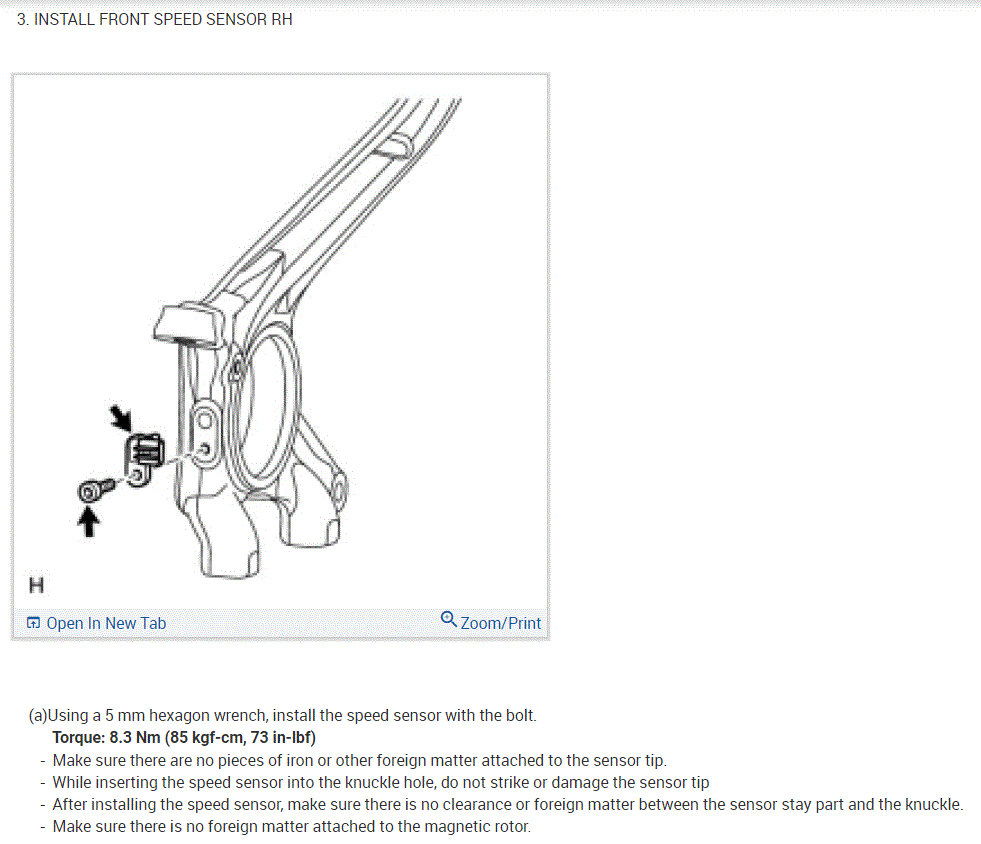

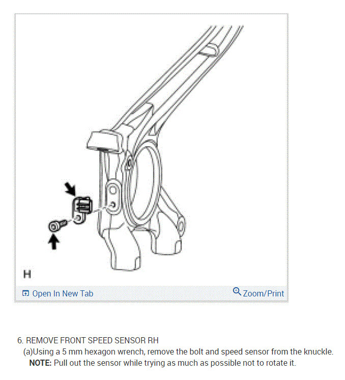

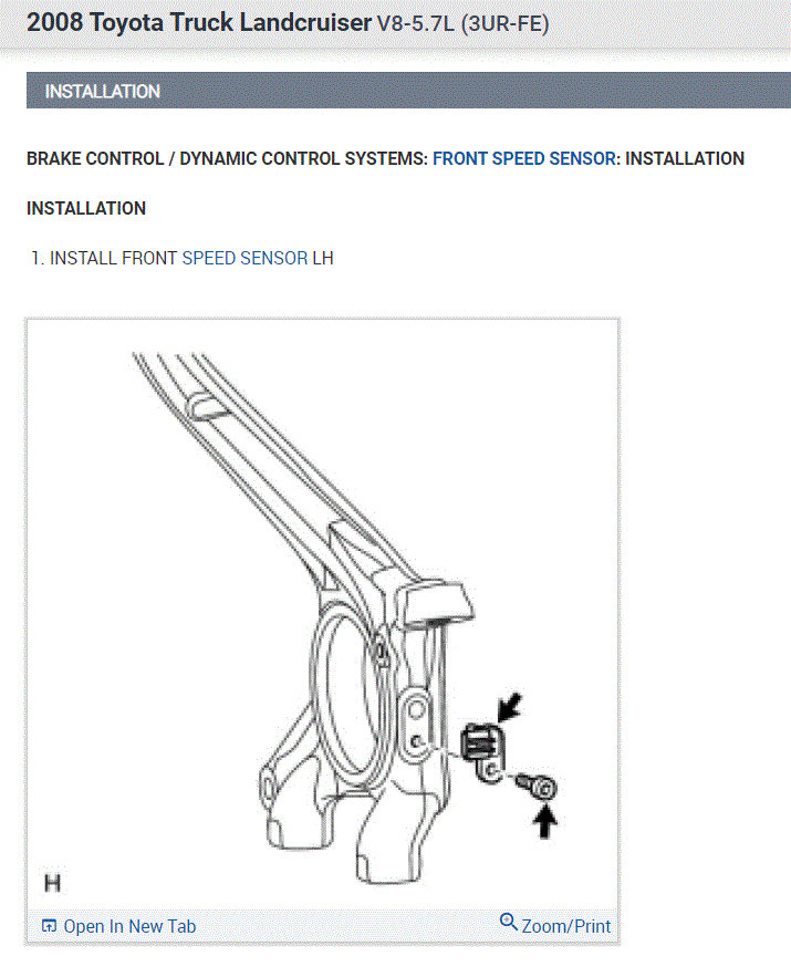

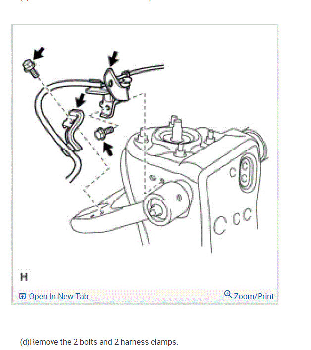

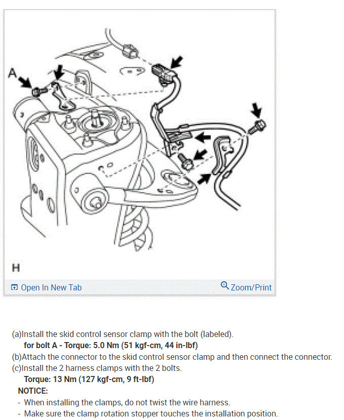

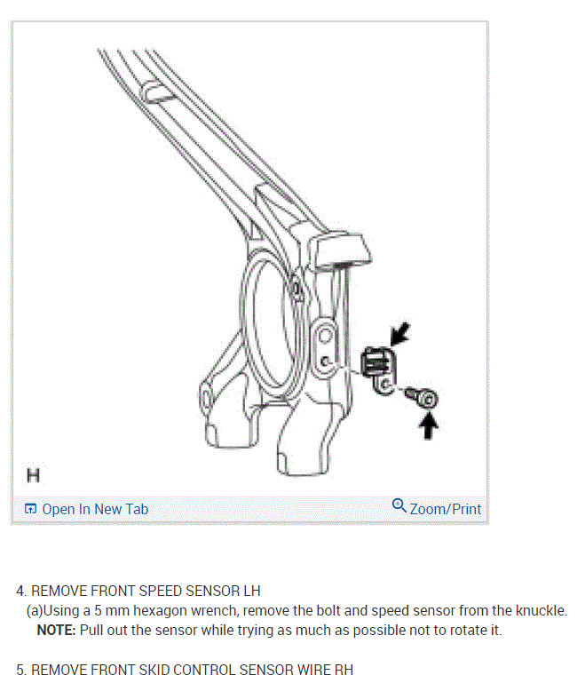

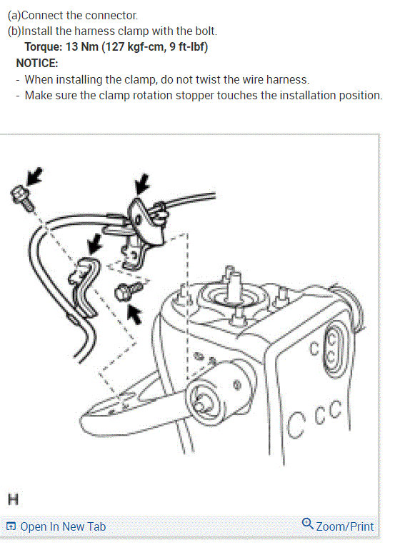

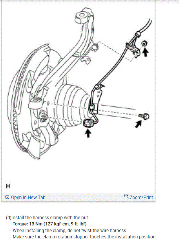

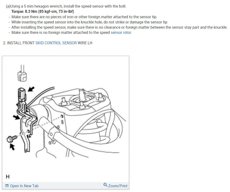

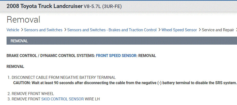

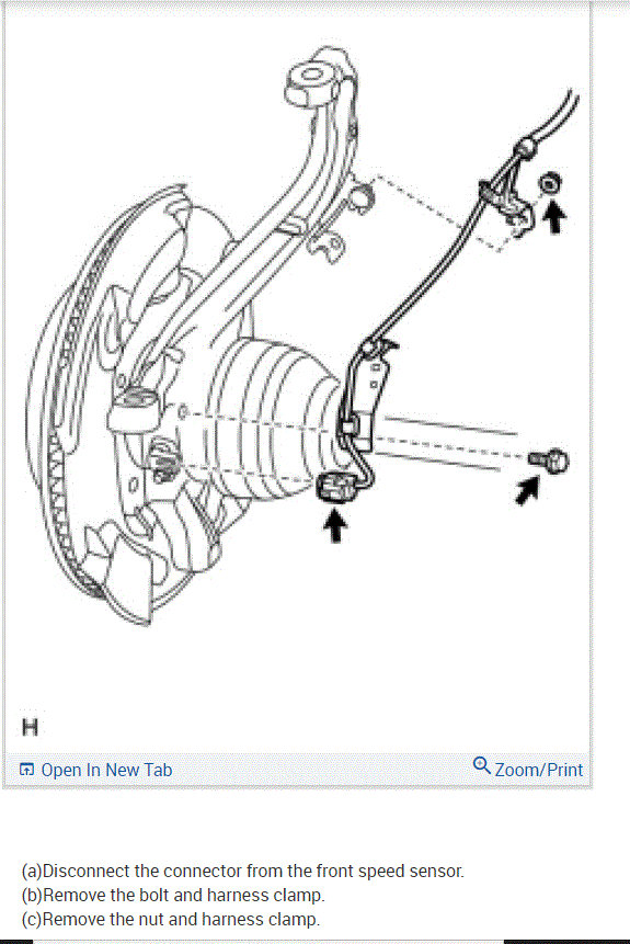

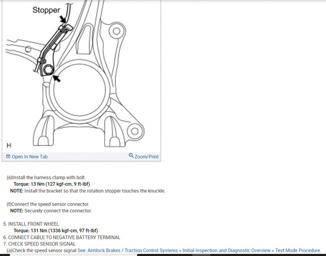

Replacing the wheel speed sensor isn't too hard. If you plan to do it yourself, make sure to purchase a lifetime replacement part. That way if it fails, you won't have to pay for the part ever again.
To get you started, here is a link that shows in general how it is done. You can use this as a guide.
https://www.2carpros.com/articles/how-to-replace-an-abs-wheel-speed-sensor
If you look at the attachments below, they include the directions and pictures specific to this vehicle for replacement.
