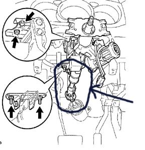

Do you need an allignment if they replace the sterring shaft assembly?
Would a bad bearing "compromise" a tire-wear it out on the inside? Would an allignment needed cause a bearing problem? After having the rear bearing assembly and hub replaced, is an allingment needed?
There was a "tire noise" after the tires were rotated last(only 15,000mi on tires-Bridgestones-air and rotated maintained)-brought back and had repair on bearing. Still have "tire noise". Went to tire shop and was told probably need an allignment-definite wear on inside of tire(not all tires, one especially).
Toyota Highlander 04, V6 4wh drive

The alignment should be done when replacing a fronat axle shaft.
A bad bearing can cause a tire wear condition....if there is play.
Not doing an alignment should not cause a bearing problem.
Not sure on the alignment for a rear wheel bearing, but doubt it.

I see you made another post. My mistake on the steering shaft...it has been a long day. https://www.2carpros.com/forum/steering-shaft-assembly-repair-vt42865.html?highlight= This is the shaft:
https://images.2carpros.com/forum/automotive_pictures/30961_stershft_1.jpg
And alignment would not be necessary as I see it. I'll let the other post go, for the second opnion!
