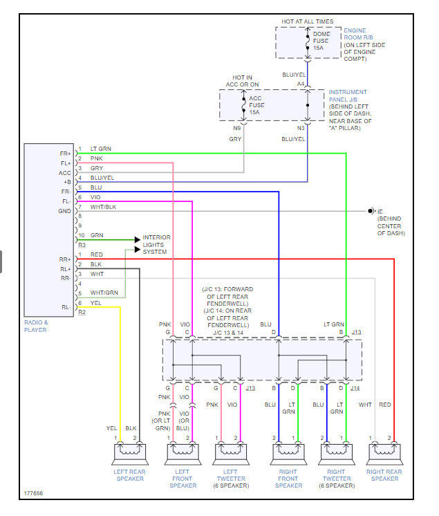

Looking for the wiring diagram for a 2003 echo

This guide will help you check the connections with the radio wiring diagrams below.

I just installed a radio in my echo but it won't power up I have power going to the plugs and out to the radio but will not turn on when I turn the lights on they illuminate the radio I got the wire info online so I have all the wires going to the right places ACC , constant , ground left , and right speaders and etc. but it just won't power up any thing would help

First you need to repost that huge sentence with some punctuation, otherwise I can read it at least three different ways that don't make sense. What do you mean by "ground left"? What do you have the vehicle ground wire hooked to? Just so I'm clear, this radio has the gray and black seven-pin plugs, right?
