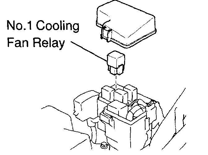

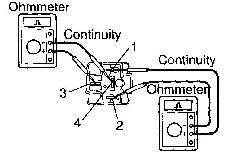

My question is, the cooling fan is running continuously and my mechanic told me that that is normal with this car. Is that true? If not, how do I rectify the problem?
Mar 23, 2019 at 4:14 AM
  • 110,244 POSTS
Welcome to 2CarPros.
FIrst, I have to explain that this vehicle isn't offered in the US, but to the best of my knowledge, the Lexus GS 300 is the same vehicle. As far as the fan, no it shouldn't run all the time. It is designed to turn on when a certain temperature is reached by the engine coolant or to run when the AC or defroster is on.
The first thing I would suggest is to check the cooling fan relays to see if one is bad. There are three of them. Here are the directions. The attached pictures correlate with these directions.

1. INSPECT NO.1 COOLING FAN RELAY
pic 1
a. Remove the relay box cover.
b. Remove the No.1 cooling fan relay. (Marking: FAN NO.1)

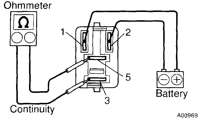

pic 2
c. Inspect the No.1 cooling fan relay continuity.
(1) Using an ohmmeter, check that there is continuity between terminals 1 and 2.
If there is no continuity, replace the relay.
(2) Check that there is continuity between terminals 3 and 4.
pic 3

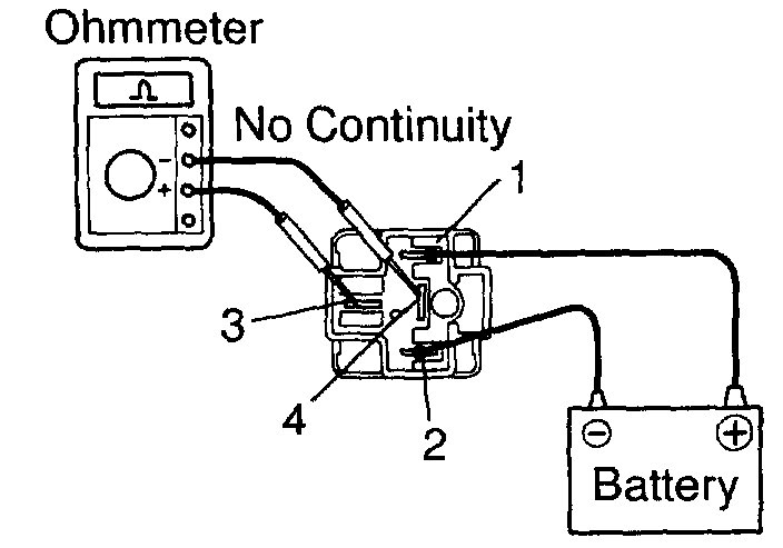

d. Inspect the No. 1 cooling fan relay operation.
(1) Apply battery positive voltage across terminals 1 and 2.
(2) Using an ohmmeter, check that there is no continuity between terminals 3 and 4.
If there is continuity, replace the relay.
e. Reinstall the No.1 cooling fan relay.
f. Reinstall the relay box cover.

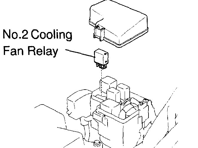

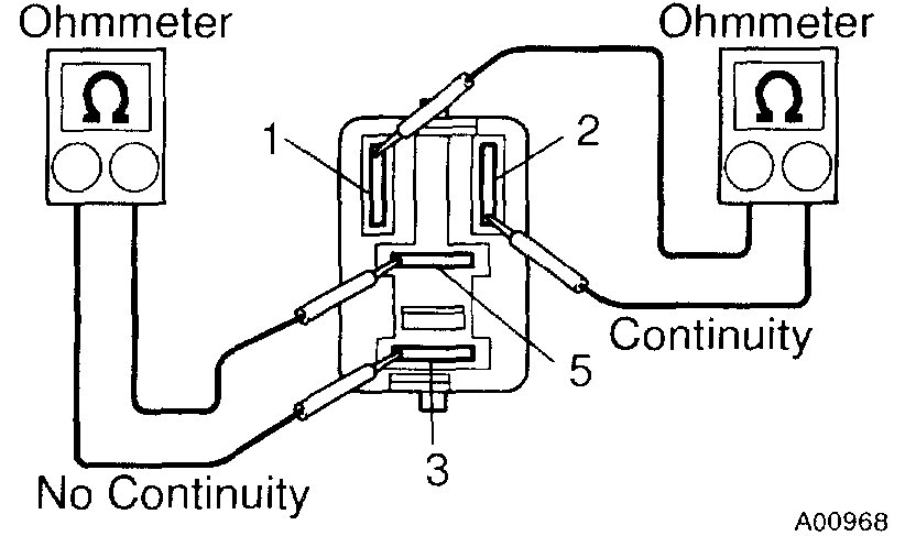

2. INSPECT NO.2 COOLING FAN RELAY
pic 4
b. Remove the No.2 cooling fan relay. (Marking: FAN NO.2)

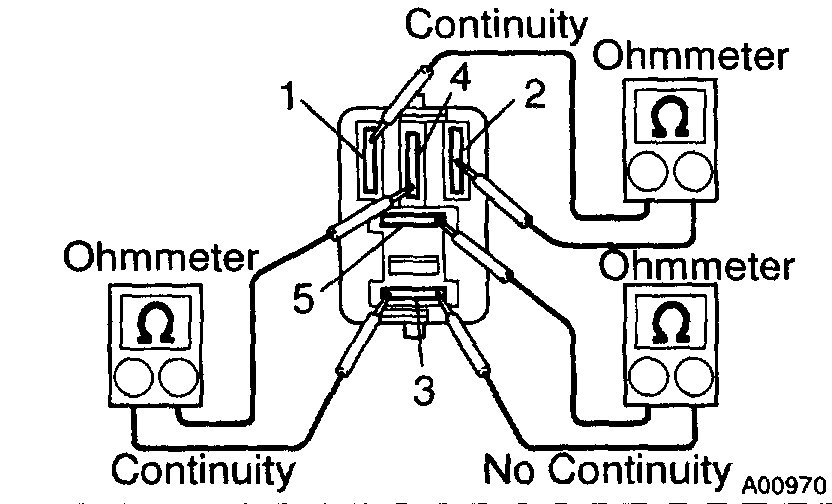

pic 5
c. Inspect the No.2 cooling fan relay continuity.
(3) Check that there is no continuity between terminals 3 and 5.
pic 6
d. Inspect the No.2 cooling fan relay operation.
(3) Using an ohmmeter, check that there is continuity between terminals 3 and 5.
e. Reinstall the No.2 cooling fan relay.

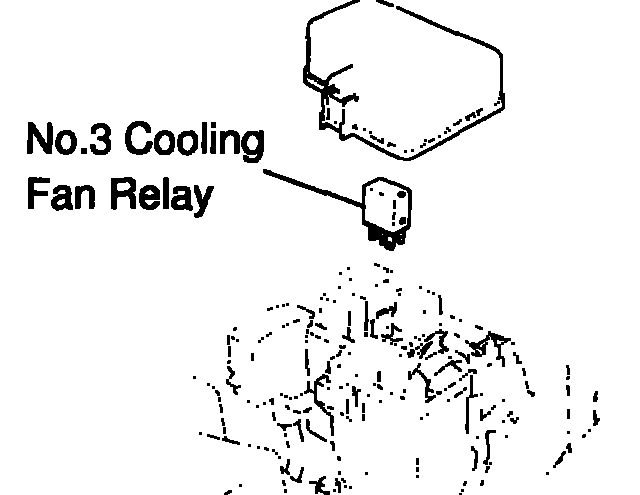

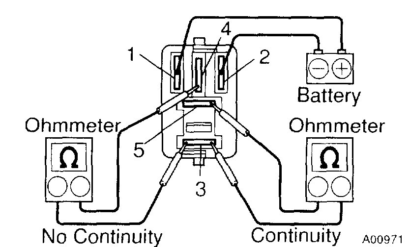

3. INSPECT N0-3 COOLING FAN RELAY
pic 7
b. Remove the No.3 cooling fan relay. (Marking: FAN NO.3)
pic 8
c. Inspect the No.3 cooling fan relay continuity.
(2) Check that there is no continuity between terminals 3 and 5.
pic 9
d. Inspect the N o.3 cooling fan relay operation.
(2) Using an ohmmeter, check that there is continuity between terminals 3 and 5.
e. Reinstall the No.3 cooling fan relay.
