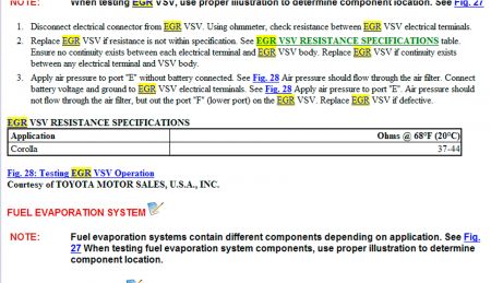

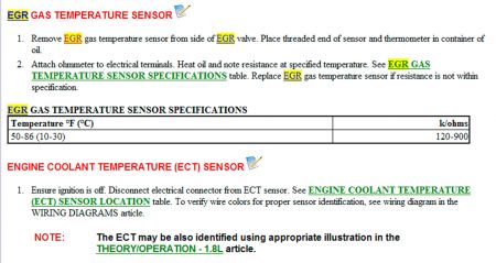

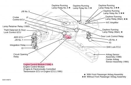

On your year the EGR is controlled by the ECM....if it doesn't open suspect a faulty ECM!
https://www.2carpros.com/forum/automotive_pictures/62217_Cor_ECM9596_copy_1.jpg
https://www.2carpros.com/forum/automotive_pictures/62217_30961_mitchell_2_20.jpg

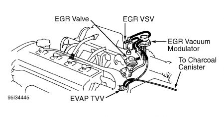

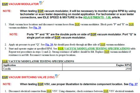

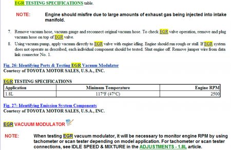

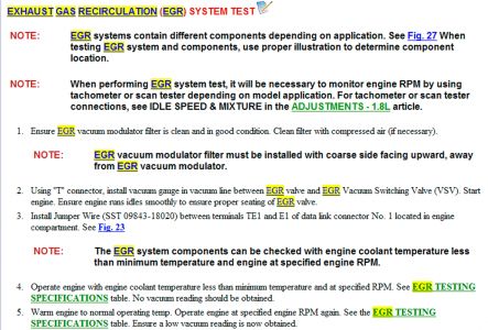

Are you ready for information overload???
https://www.2carpros.com/forum/automotive_pictures/62217_EGRDIA_1.jpg
I think by this picture the flex tube is comming out of the modulator, but you can tell better than me.

Hi merlin2021--thanks for replying.
The tube that looks coming out of the modulator does not supply exhaust to the EGR. To the contrary, exhaust gas “goes out” (it doesn’t actually flow) from the EGR to the modulator through this tube.
There is no flex tube to supply exhaust. The EGR is bolted onto the intake manifold. Its bottom has two airway openings. Exhaust gas enters the lower opening into a pressure chamber inside the EGR base, then passes around the EGR valve when it opens, and goes out of the upper opening into the intake manifold. Unlike Ford cars that use a flex tube to get exhaust from the exhaust manifold (as you said), there is no flex tube here. Exhaust comes from a path that is built-in inside the intake manifold, but I have no idea where it comes beyond that.

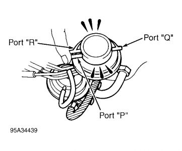

The pressure chamber inside the EGR valve base has an opening that lets exhaust gas, through this tube, to pressure on a diaphragm inside the modulator. The modulator’s P port gets vacuum when the throttle is opened but not too wide. Inside the modulator, P is connected to the atmosphere and vacuum is destroyed and can’t reach Q (the output port) if this connection is not shut off. With sufficient exhaust pressure, the diaphragm will shut off the atmosphere connection to P so that vacuum will reach the EGR valve to open it. Port R gets vacuum when the throttle opens wider. R is not connected to the atmosphere and vacuum always passes to Q.
