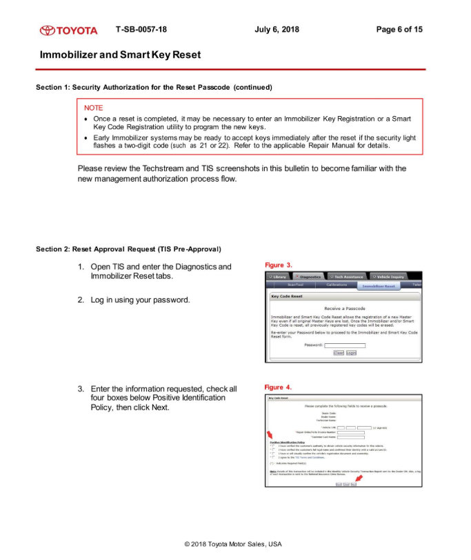

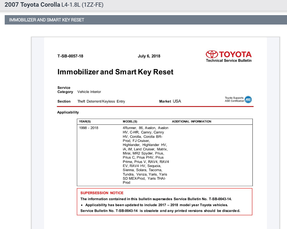

Hello, I want to get the on-board programming directions for making a duplicate ignition key. I have the key blank bought on e-bay, and I've had it cut. Also, I of course have the original working key, just need on-board programming instructions to duplicate it. I know others have done this themselves without having to pay over $100 at the dealer. I have heard the procedure has something to do with stepping on the pedals in a certain sequence.
Nov 1, 2009 at 9:15 AM
STEVEW84
  • 673 POSTS

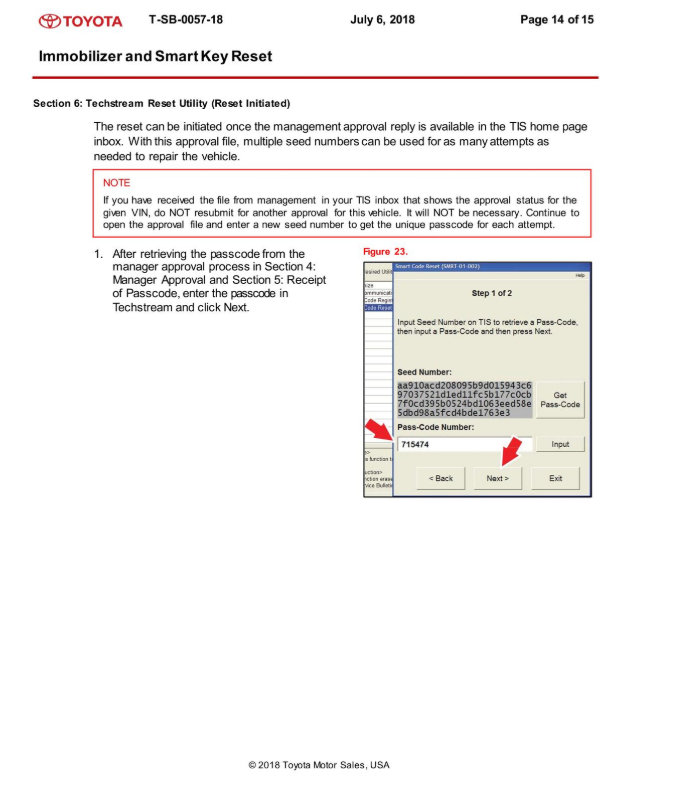

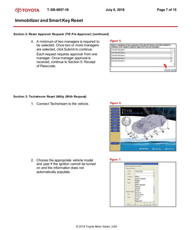

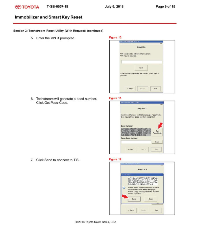

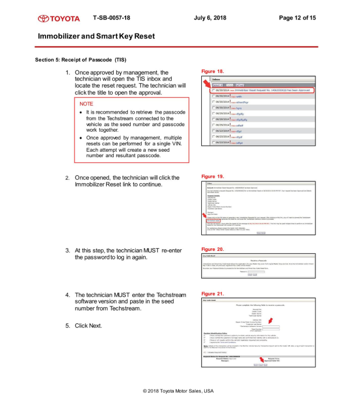

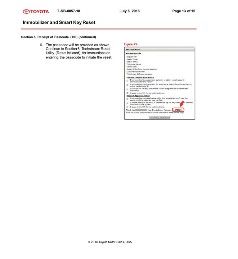

Here are the instructions of the immobilizer and smart key reset. Check out the diagrams (Below). Please let us know if you need anything else to get the problem fixed.
