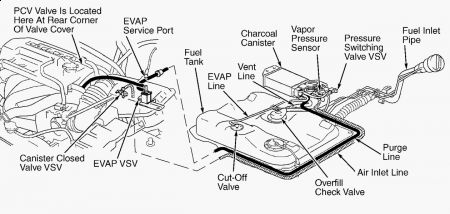

You have helped me solve problems with my vehicles. Now I need your help to solve a problem with a friend's vehicle.He is short on funds, knows nothing about cars, so I'm hoping I can fix it for him. His engine light came on and with my scan tool, the code P0446 was listed as the causative factor. I found out that the P0446 code corresponds to the evaporation emission control system vent control circuit malfunction. A person told me that this code relates to the canister shut valve and that I should replace the canister as well.I went to a local Toyota dealer and the most information I could obtain from them is that four different valves that relate to this code; however, one is the canister assembly that has the shut valve. I believe that I have located the canister by the fuel tank. I would appreciate any information (and diagrams as he does not have any repair manuals) you can give me so that I can repair his Toyota
The car is a Corolla CE. The only thing written on the engine is 16V VVT-I. I cannot find anything that lists the engine displacement. I hope this is enough information.

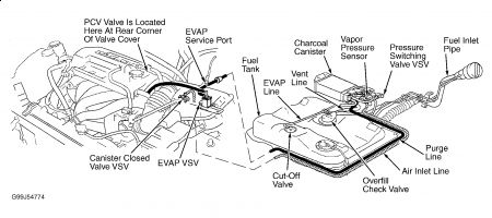

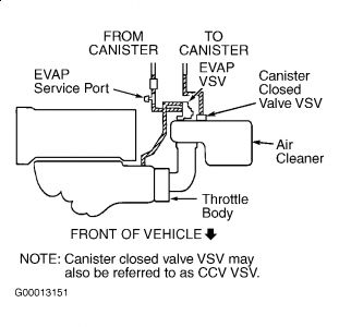

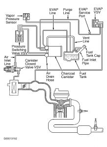

Hello - Thanks for the info....... I show this code can be one of several things. Circuit Description Vapor pressure sensor, canister closed valve Vacuum Switching Valve (VSV) and pressure switching valve VSV are used to detect faults in EVAP system. DTC is set if EVAP system leak is detected or if there is a malfunction in EVAP VSV, vapor pressure sensor VSV or in vapor pressure sensor. Possible causes are: "¢ Damaged, disconnected or blocked vacuum hose(s). "¢ Fuel tank cap is installed incorrectly. "¢ Defective fuel tank cap. "¢ Vapor pressure sensor circuit is open or shorted. "¢ Defective vapor pressure sensor. "¢ EVAP VSV circuit is open or shorted. "¢ Defective EVAP VSV. "¢ Canister closed valve VSV circuit is open or shorted. "¢ Defective canister closed valve VSV. "¢ Pressure switching valve VSV circuit is open or shorted. "¢ Defective pressure switching valve VSV. "¢ Damaged fuel tank. "¢ Defective charcoal canister. "¢ Fuel tank overfill valve cracked or damaged. "¢ Defective ECM. Is the vehicle running rough, bad in any way or just threw the code? If it is running basically okay, then this is my suggestion especially since short of funds. Check all of the vacuum hoses really good. Especially the small ones and areas of sharp bends, sitting against something that could chafe etc, look at the area that it connects to for brittle and splits. I have attached 3 pic below to assist. Next, I would replace the fuel cap. Then clear the codes and drive it and see what you find.
https://images.2carpros.com/forum/automotive_pictures/248015_1_188.jpg
https://images.2carpros.com/forum/automotive_pictures/248015_2_124.jpg
https://images.2carpros.com/forum/automotive_pictures/248015_3_88.jpg
It may be the canister etc.........but, when looking at the chart above I would start with the most probable and work my way down. Most of the time I have found either a defective hose or mostly the fuel cap.

Thanks for all the information and great diagrams. I forgot to mention that I had him replace the gas cap and I reset the code. It lasted about a week until the light came on again with the same code. The vehicle runs fine with the exception of the light staying on. I will look at the hoses( the pictures will be very helpful) next and report back.

I apologize for taking so long to get back to you, but I could not coordinate my schedule with my friend's to look at his car. On Sunday I was finally able to inspect all the hoses that you diagramed for me and all appeared to be in very good condition.
Please let me know what my next step should be. If I should replace the canister/valve, how difficult will it be to remove this from the vehicle.

Since ANY of the hoses, or valves in this sytem could be the problem, it would be wise to spend the extra money to test the system first! Mechanics use a smoke machine to pump 2psi of smoke into the system, where the smoke leaks out, the part is replaced. Throwing parts at it to try and help is a waste of your time, and friends money! Carefully check the gas fill tube, if the upper half is metal, look for pinhole rust on it...ANY hole, even a pinhole will set the code you have. EVAP VSV in engine compartment is more likley the cause than the canister.

On that diagram of the EVAP system under the hood, Canister Closed Valve VSV, what is the part number for it? What is the function of it? I thought there is a only purge solenoid (EVAP VSV on the diagram) under the hood.
