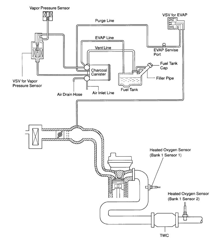

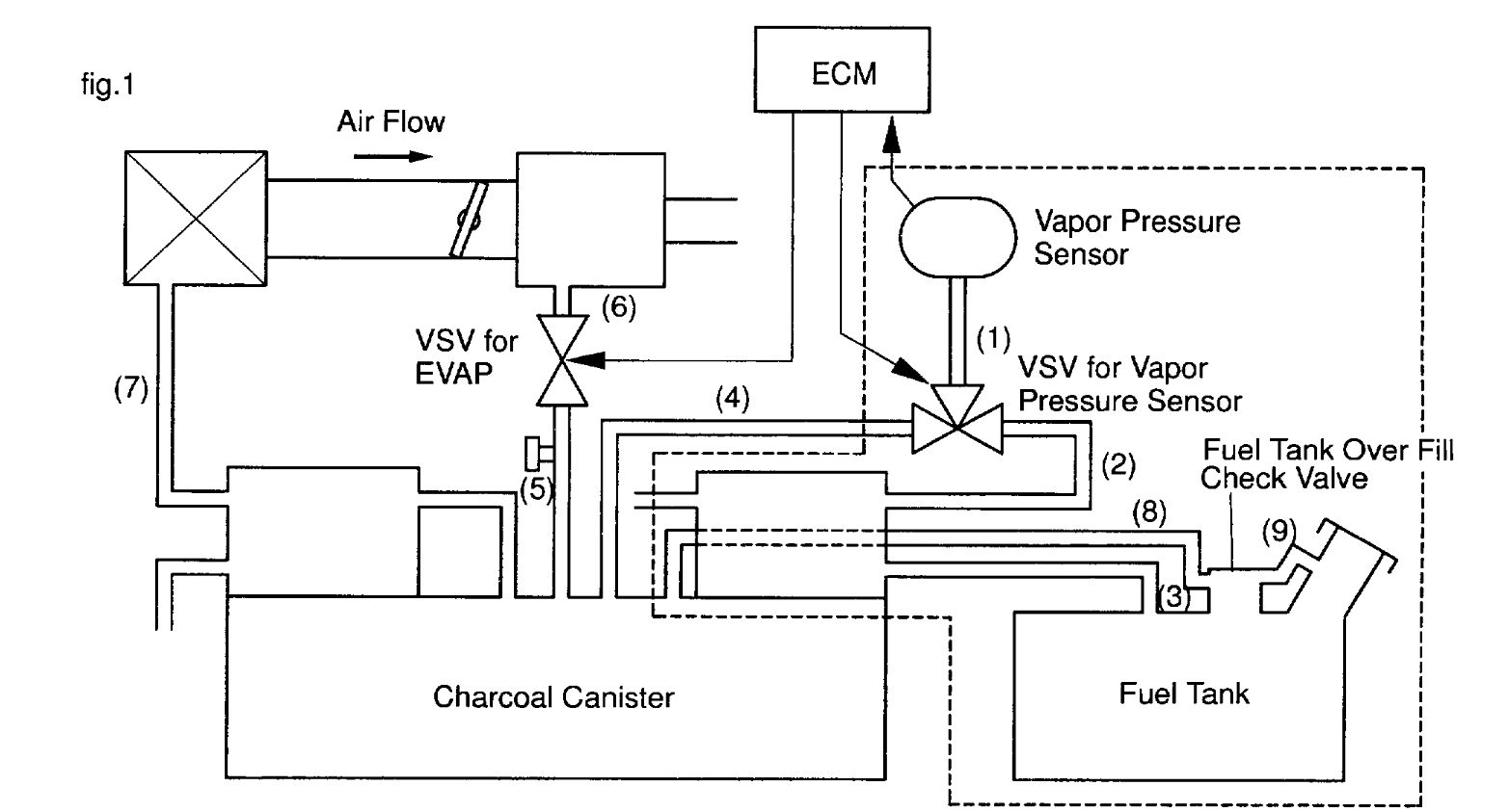

ARNIE53
It has been a wonderful,dependable car,and with only 91,000 miles on it. The Vacuum hoses,that go from the Canister,that is located underneath the car,in between the GAS TANK,and the TRUNK,the hoses are broken,and leaking. Where can I get vacuum Diagram,for this. Need ASAP
Nov 12, 2019 at 3:52 AM (Merged)
  • 75,992 POSTS
Here is the vacuum line diagrams for the EVAP and vacuum systems. Check out the diagrams (Below). Please let us know if you need anything else to get the problem fixed.
ARNIE53
Thank you for your reply. It was just what I needed. I love this site
