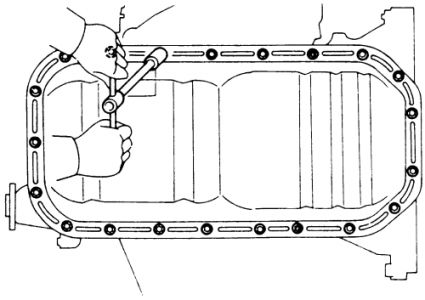

I ran into a problem when I tried to replace the oil pan gasket on my 88 corolla. I am at the stage where I have removed all but to bolts. My problem is that I can not get to them (next to the transmission). I was told that I may have to remove the center mounting, but I think it must be a easier way to get access to those last bolts. Can you recommend me what I need.

Here is the removal and install REMOVAL & INSTALLATION 4A-F, 4A-FE and 4A-GE Engines Disconnect the negative battery cable. Raise and safely support the vehicle. Drain the engine oil in a suitable container Place a jack under the transaxle to support it. Remove the splash shield from under the engine. Raise the jack under the transaxle slightly. Remove the front pipe from the exhaust manifold and catalyst. Some models have a oxygen sensor, disconnect the wiring. On the 4A-F and 4A-FE engines, remove the center mounting. Some 4A-FE engines and all 4A-GE engines are equipped with a stiffener plate. Remove the set bolts and pull the stiffener plate from the vehicle. On the 4A-GE engines, unbolt and lower the flywheel housing under cover. If equipped, remove the oil cooler hose and union from the oil pan. Remove the two nuts and nineteen bolts retaining the oil pan. Insert a blade between the pan and cylinder block, cut off the applied sealer and remove the pan. To install: Be careful not to drop any oil on the contact surfaces of the pan and block. Using a razor blade and gasket scraper, remove all traces of packing (FIPG) material from the gasket surfaces. Thoroughly clean all main surfaces to remove loose material. Clean both sealing surfaces with non-residue solvent.

Apply new packing (FIPG) 08826-00080 to the oil pan as shown. Avoid apply excessive amounts to the surface. Be especially careful around the oil passages. Parts must be assembled within 3 mins of application. Otherwise, the sealer (FIPG) must be removed and reapplied.
