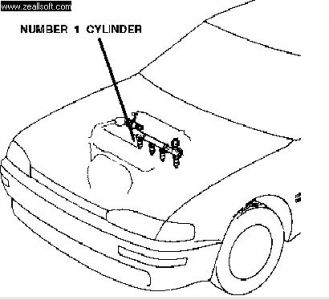

thanks!- Had already tried your advice (wet ditributer cap) with no success. Any other advice?
Do you think the timing may need to be adjusted?
And do you know the location of the #1 piston on this vehicle, the piston by the timing chain or the one by the distributer?
thanks.
http://www.2carpros.com/forum/automotive_pictures/99387_toy_5.jpg
hope that help
check the firing order if u had already cahenged the cap
