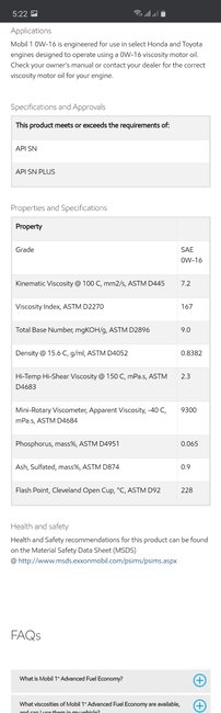

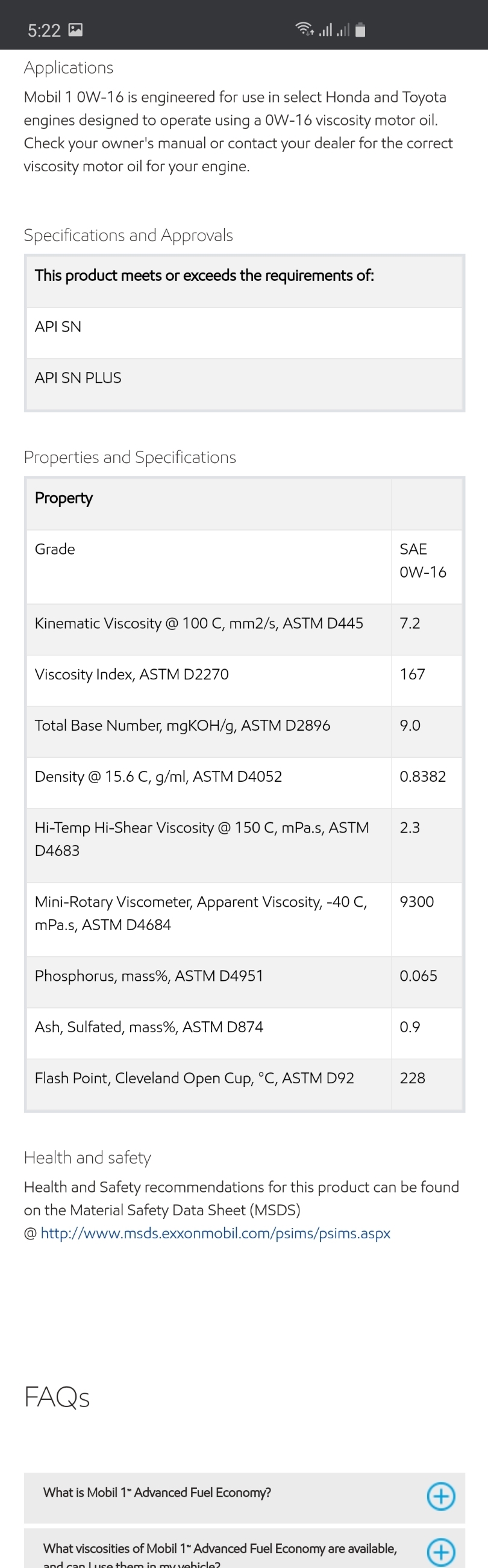

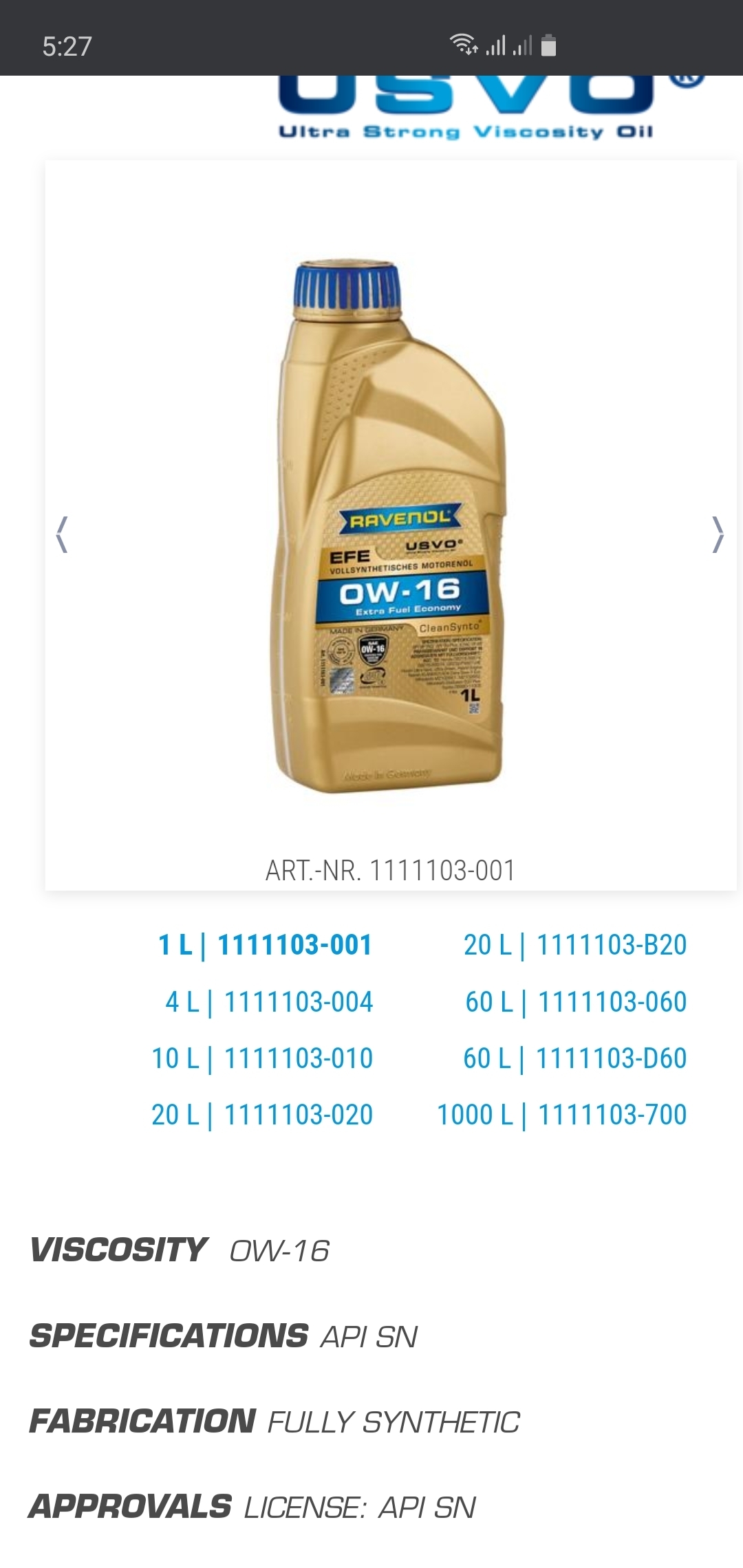

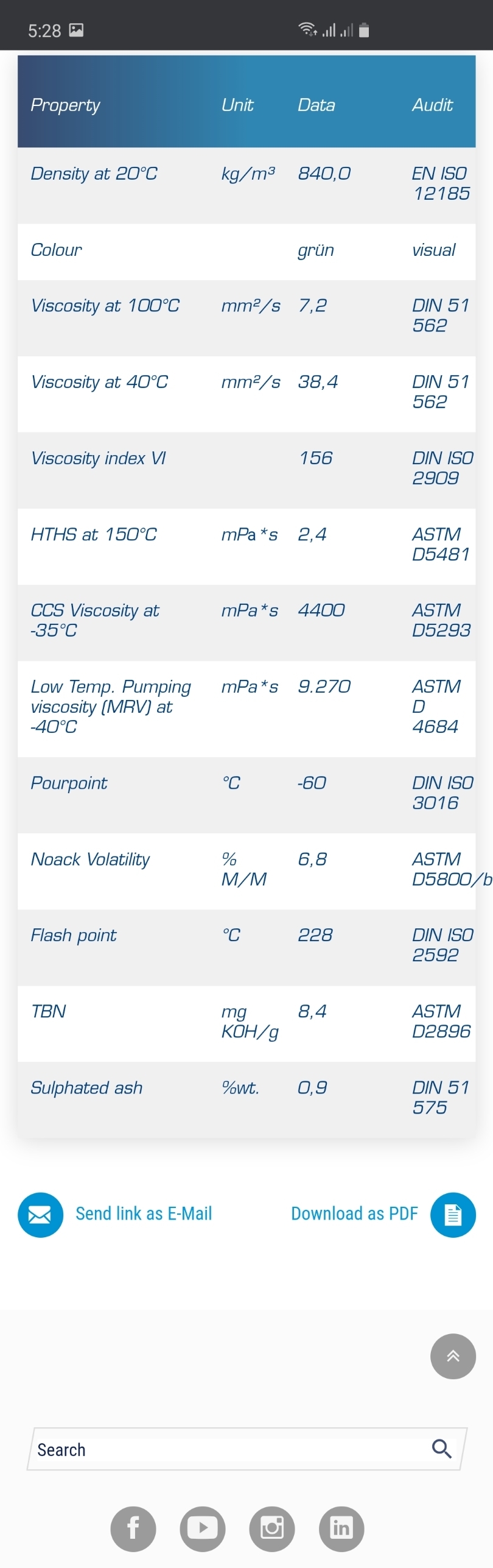

Recently I bought the car listed above LE model and i was wondering if i can use Ravenol 0w-16 fully synthetic API SN instead of Mobil1 0w-16 fully synthetic API SN?because i cannot find Mobil 1 in my place.
I mean can i use another one instead of Mobil 1 as long as it has the same specifications?

Good evening,
Yes you can as long as the specs are the same. There will be no issues using other brands as long as the specs meet OEM requirements.

Yea, i keep replaying but it's not posted not sure why maybe. i am not allowed to post link. anyway i posted a link to both specs of Ravenol and Mobil 1 0w-16.

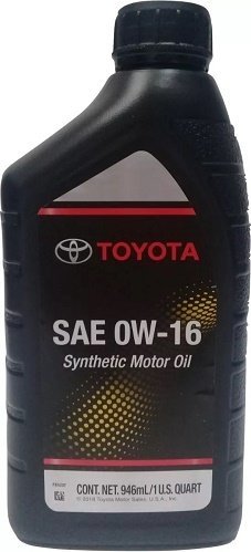

The one with the picture of the bottle is good.
I would use that as it meets the specs.
Apr 27, 2020 at 12:30 AM
