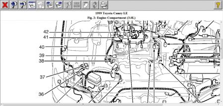

I stop my carabout 5 months. Now I start back drive. I have already open and clean my engine and change barring. When I driving car moving is good. The heat indicator and all the other indicators are ok. But engine oil indicator is appear and disappear when I was driving. I have no idea about that. I already clean and change engine oil. Pl help me sirl. I have financial trouble. I want to use my car for my families emergency. Thanks a lot Sir.

Do you hear any type of engine knocking noises if not replace the oil pressure switch
Oil Pressure Switch (3.0L) On lower left front of engine block-see location no.39
https://www.2carpros.com/forum/automotive_pictures/12900_op_6.jpg
