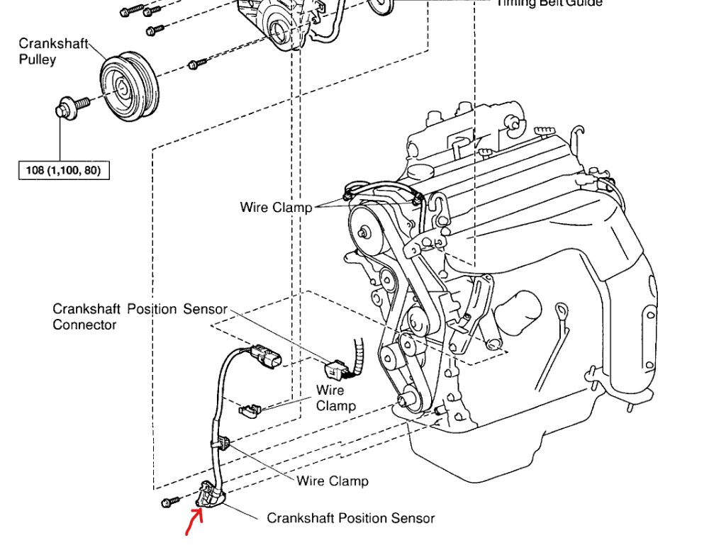

My car has been driving just fine today but when I stopped at a store for a few minutes and came back to it. Wont start. The engine is turning but wont crank. Feels like there is no fuel getting to the engine. Is there a shut off valve in this vehicle and if so where is it located?Thanks

It sounds like the crankshaft angle sensor has gone out which is common, here is a video so you can check for spark to help confirm the issue:
https://youtu.be/baq_aEWNQ0Y?si=K09ZkdePKKIuBAkU
Please go over this guide as well:
https://www.2carpros.com/articles/car-not-running-advanced
Also, you should check the timing belt. Check out the images (below). Please let us know what happens.
