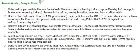

this is my first time using this site. I have a 1998 camry, I was toild by a local mechanic working out of his garage(a friend of a friend) that i needed to replace the wheel hub assembly for my left front side. He agreed to do it, and I bought the part, but now I can't get him on the phone. I've replaced brakes and alternators before, and I'm wondering if I need any special tools to replace this, and how esy it is. It came with the weheel bearing as well......

https://images.2carpros.com/forum/automotive_pictures/261618_Noname_2552.jpg

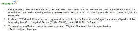

https://images.2carpros.com/forum/automotive_pictures/261618_Noname2_830.jpg
