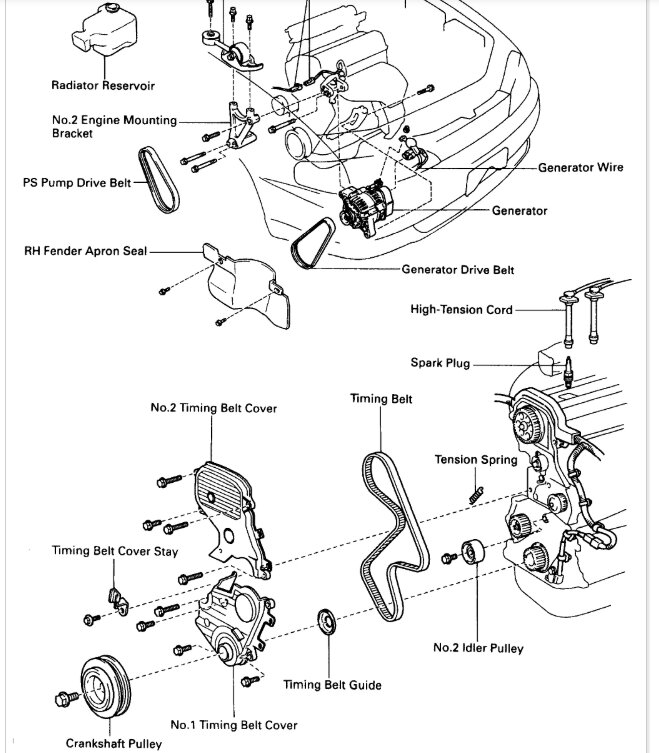

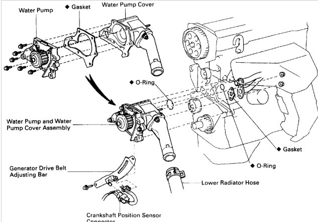

I need diagram and instructions on how to replace water pump and replace the serpentine belt.
Monday, October 26th, 2009 AT 8:17 PM
BMRFIXIT
MECHANIC
19,053 POSTS

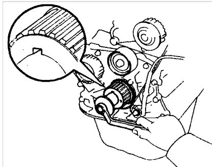

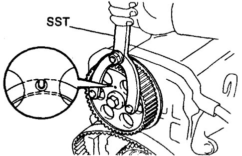

This page have the timing belt
https://www.2carpros.com/car_repair_information/year/1996/make/toyota/model/camry/1996_toyota_camry_timing_belt_diagram_marks.htm
and this page has the surp.belt
https://www.2carpros.com/car_repair_information/year/1996/make/toyota/model/camry/1996_toyota_camry_drive_belt_routing_diagram.htm
