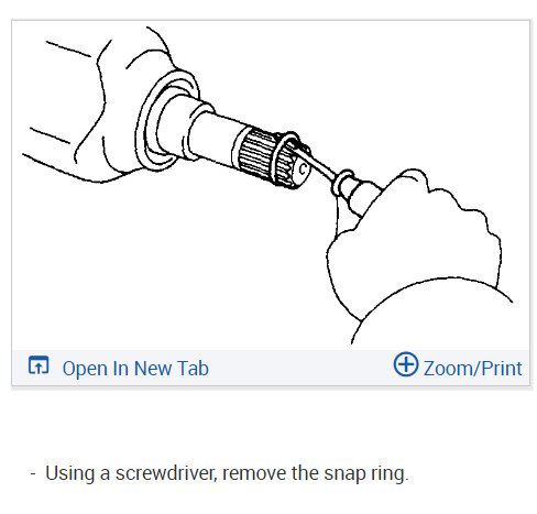

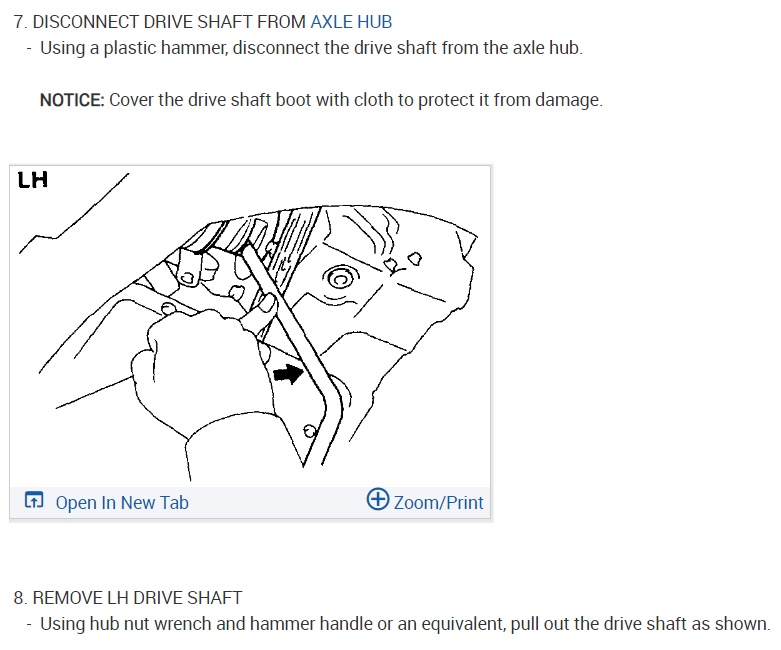

Hi, I'm looking to purchase a used car for my wife and dont want to spend alot of money on fixing it up. I've been looking around and have test driven quite a few. The one that I'm intrested in is a 1993 toyota camry. Everything that I noticed about the car seems to be in pretty good of shape! Runs like a brand new car! I don't hear any noise, breaks perfect! I did notice that when I make a left or right turn it makes a noise that sounds like gluck gluck gluck. Im not sure what it is? I was thinking it could possibly be the CV boot, or drive axle. The owner said it may possibly be the manifold, but I dont agree with that. What do you think some of the possibilities may be? I just want to know so I can check around for prices before I actually make the decision in purchasing the car and end up pouring alot of money into it! Also, During driving you can hear a noise, it's actually not very noticeable. It gets louder when you accelerate Could that be the muffler? I noticed the engine revs high while Idle, but during acceleration, or staying at a constant speed it's fine. Could that be a problem that needs to be fixed? or is that something common in these vehicles?

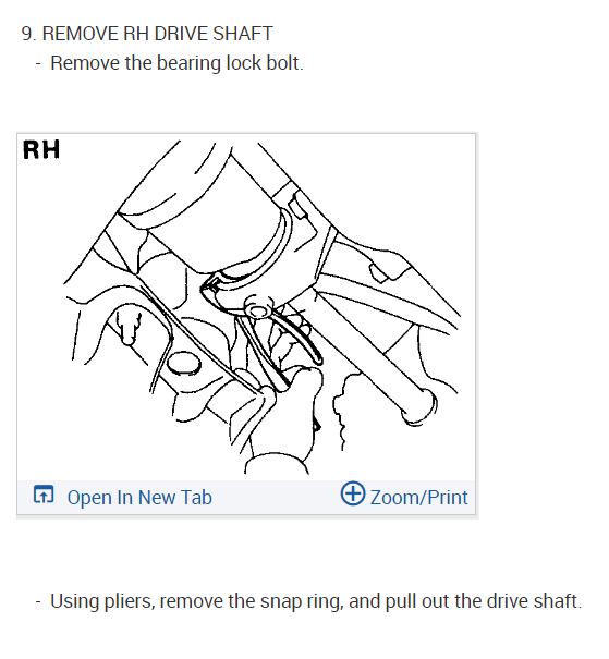

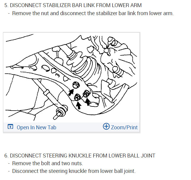

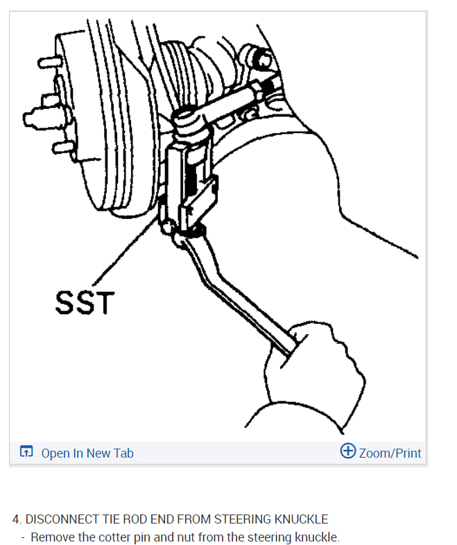

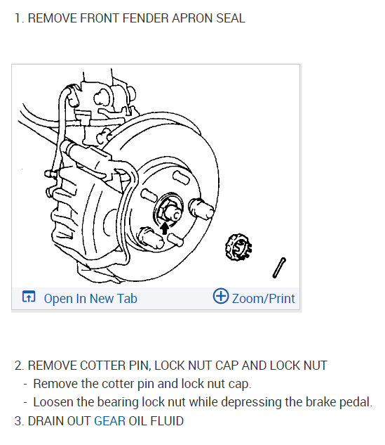

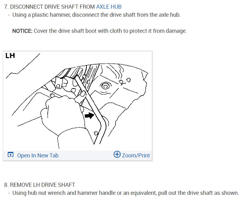

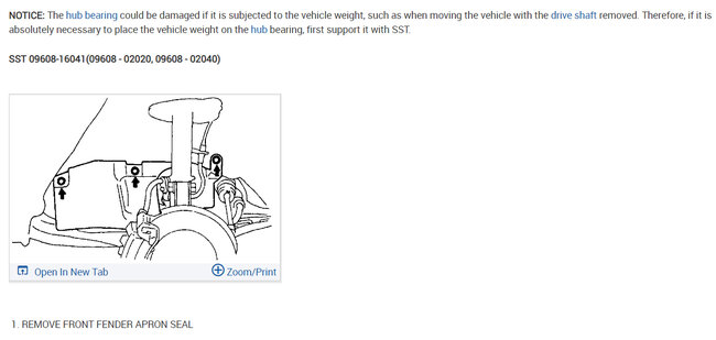

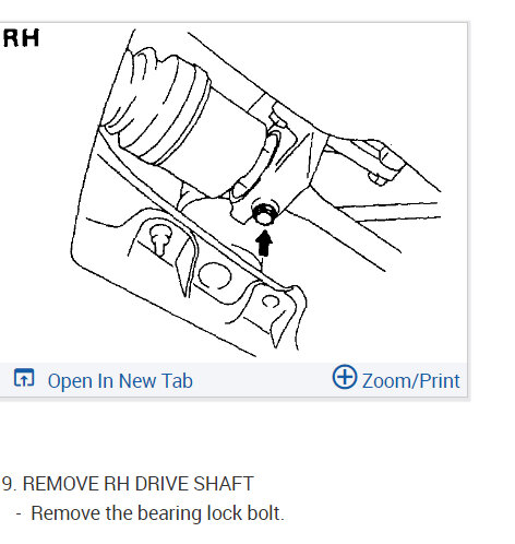

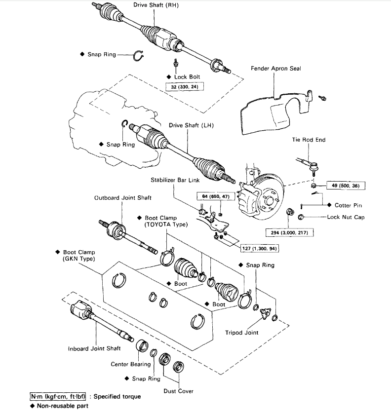

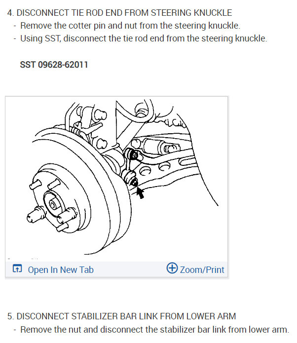

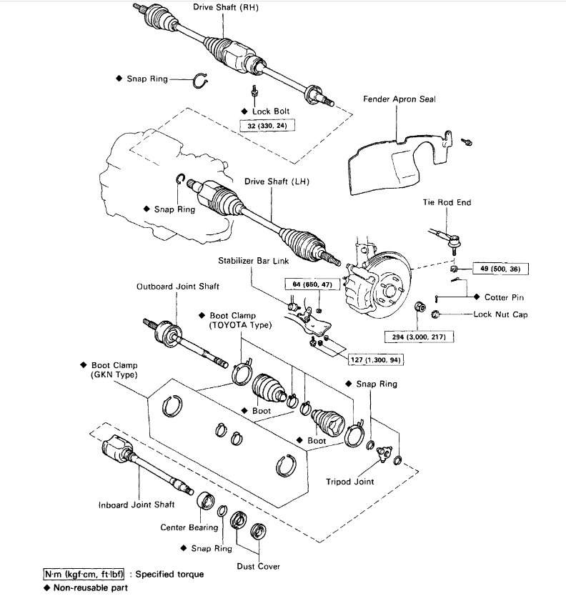

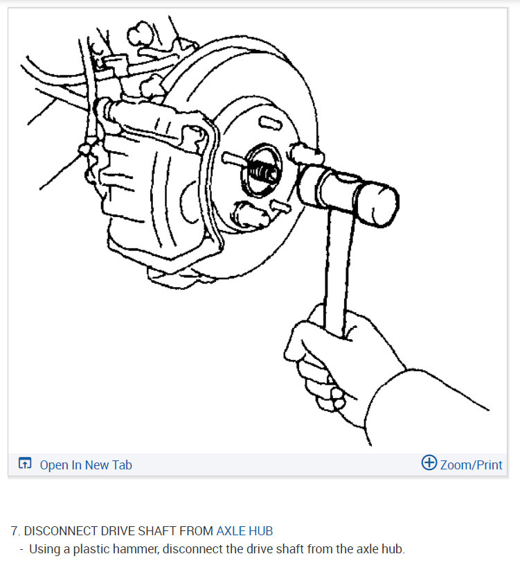

yes you should turn the wheel out both ways and at least look at the cv-boots, are they torn? If so youll need to change the axles!
Dec 8, 2007 at 11:10 AM
  • 55,423 POSTS

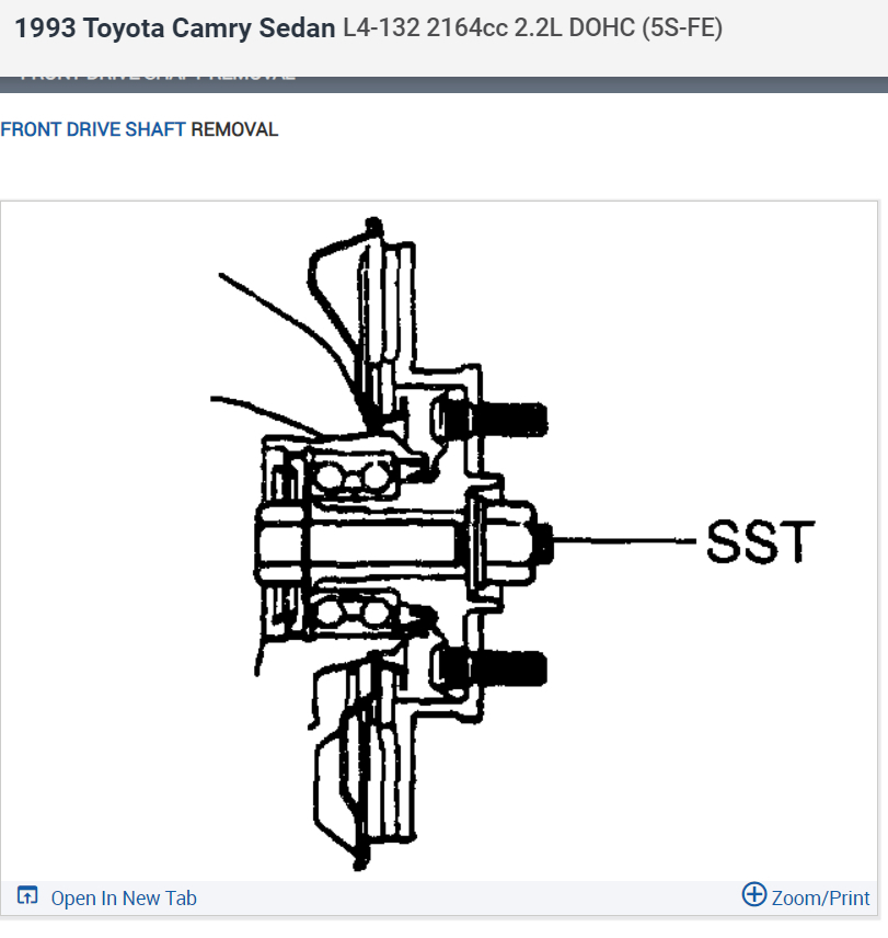

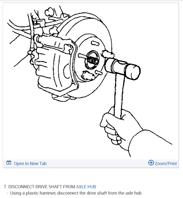

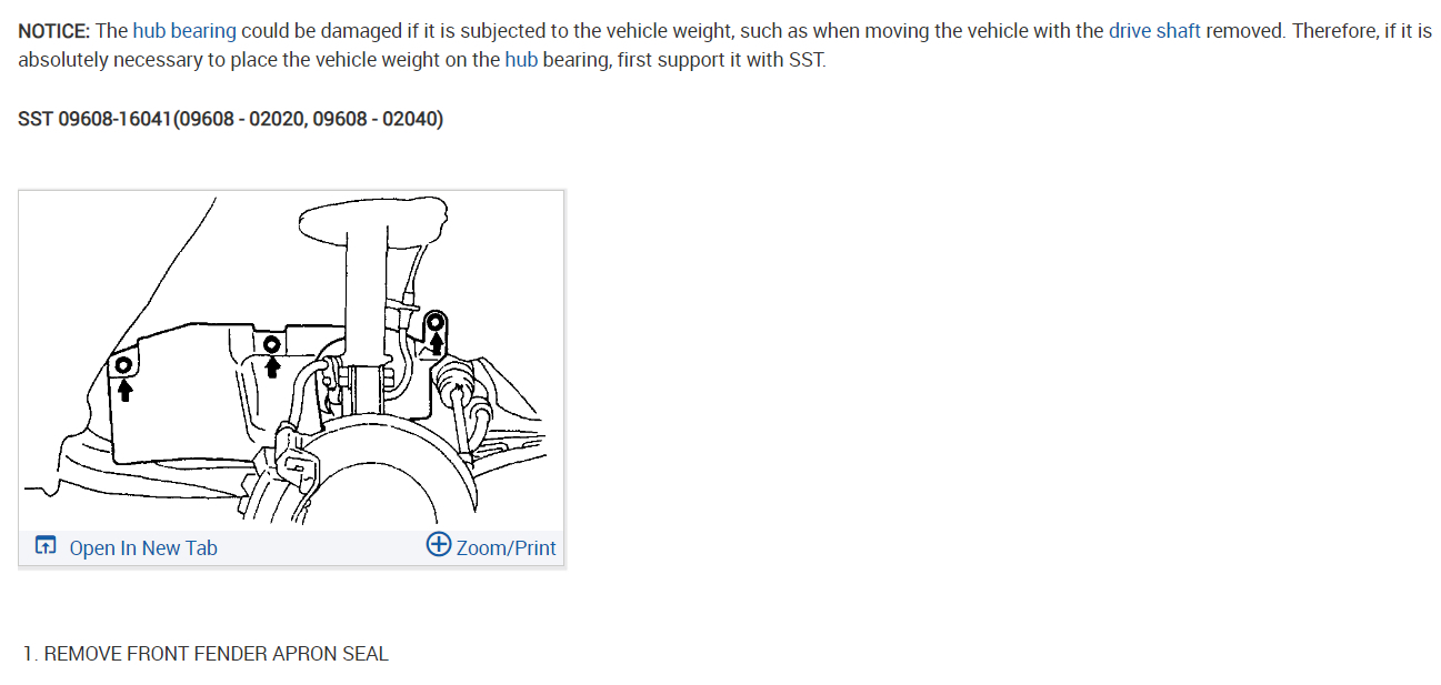

Yep, I agree with MERLIN2021 the CV axle will make this noise while you turn, here is how to change them out. Check out the images (below). Please upload pictures or videos in your response of any problems so we can see what to help you with.
