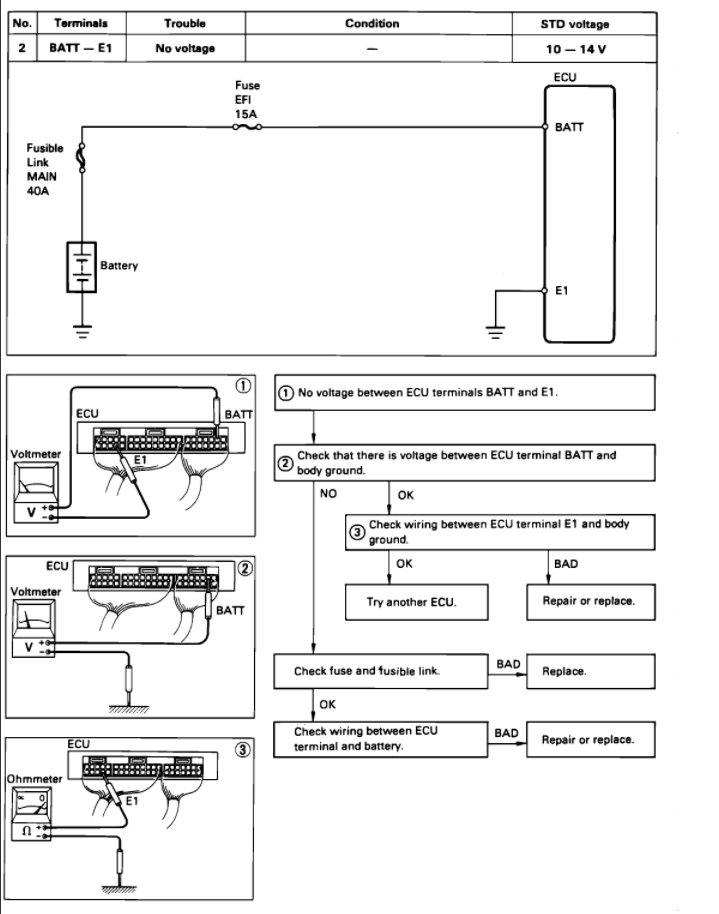

If the computer don't get the Ne and G signals it will not give an Igt signal to the ignitor telling it to fire the coil, further NO Igf signal to the computer tell it that combustion has occured-Therefore end of result no secondary surge to the plugs.
Check the pick up coils resistances-

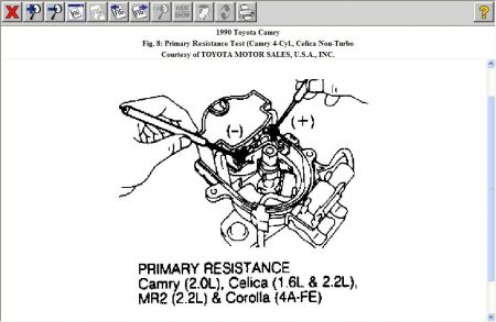

BERETTAGT
My car recently i had jumped with a piece of metal my EFI fuse and had been driving it about 180 miles and all of a sudden it just had no power and burnt out a couple fuses i replaced all the bad fuses and all my fuses are working now but my car will still not start and is not getting a spark for some reason i replaced the cap and rotor brand new less then 300 miles on them was wondering if you knew where i should look to figure out why its not getting a spark if theres maybe a wiring diagram i could look at.
Aug 2, 2020 at 11:23 AM (Merged)
  • CERTIFIED EXPERT
  • 75,992 POSTS
Check the ignition fuse/look for power at the coil/test the resistances of the distributor pick-up coil/ignitor-
BERETTAGT
ignition fuse is getting power,
How would i check to see if the coil is getting power to it?
  • CERTIFIED EXPERT
  • 75,992 POSTS
Remove the distributor cap and test coil positive terminal to ground-see below
https://www.2carpros.com/forum/automotive_pictures/12900_dizzy_1.jpg

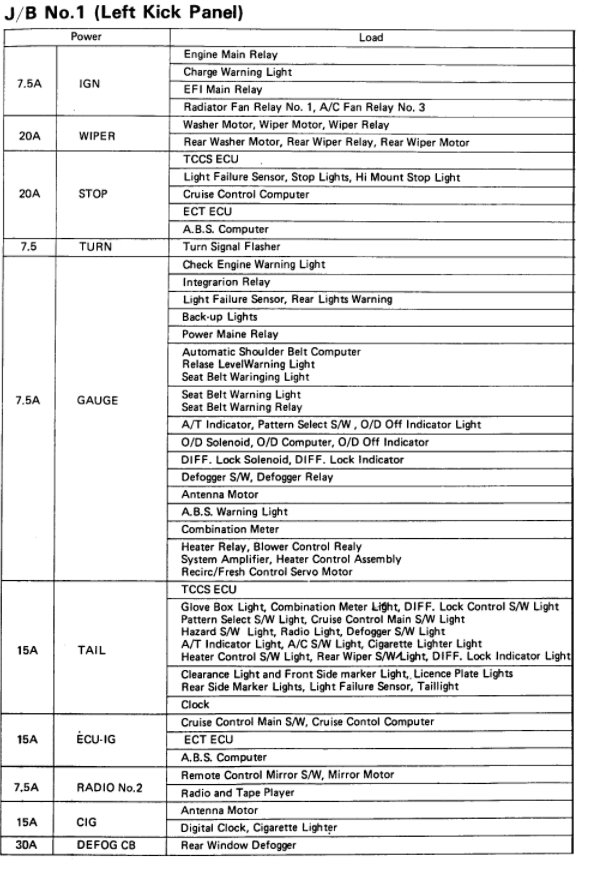

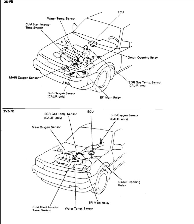

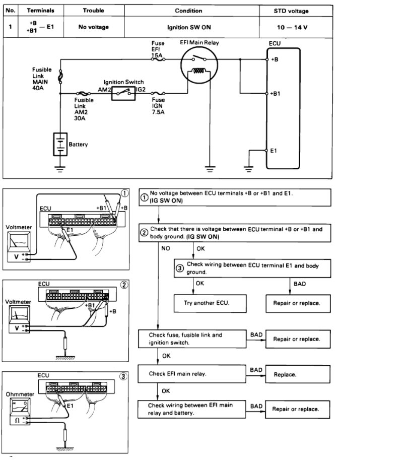

  • CERTIFIED EXPERT
  • 53,884 POSTS
It sounds like the system is not getting power which is supplied by the EFI relay.
Here is its location along with a couple guides on how to check it:
Also check the fuses.
