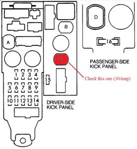

All of a sudden, both front seatbelts stopped working.
Is there a fuse or relay designated for the seatbelts?
Where is it located?
Please HELP!
Thank You

https://www.2carpros.com/forum/automotive_pictures/55316_89camryfuse_1.jpg

OK, thanks for the info. I have some new info about the problem also.
If the outside temps stay reasonable, then everythimg works fine. Yesterday I parked it in the shade and when it cooled down for the evening. The seatbelts started working again.
Could this still be the relay?
Monday, May 18th, 2009 AT 8:55 AM
ZACKMAN
  • 4,202 POSTS
Yes, the relay can be still faulty.
