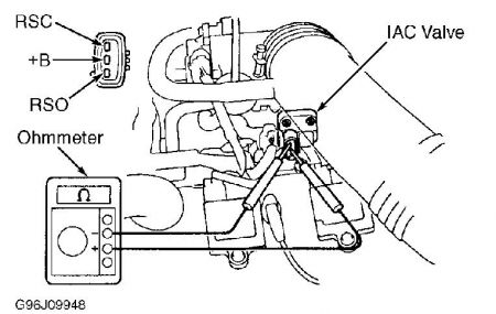

Hello!
Start checking the IAC valve (Idle air control valve)
remove it and clean all gummed area and varnish..
Usually that valve its responsible to control the idle and increase it under "load"
let us know how is it!
Good Luck!

IAC Valve Location and test:
https://images.2carpros.com/forum/automotive_pictures/576_avalon_99_iac_1.jpg

I started with IAC valve. But it soon became too much for me I sent it to my friend mechanic for a tune-up(One is due anyways). According to him, it was a dirty dirty throttle.
Problem fixed after $400.
