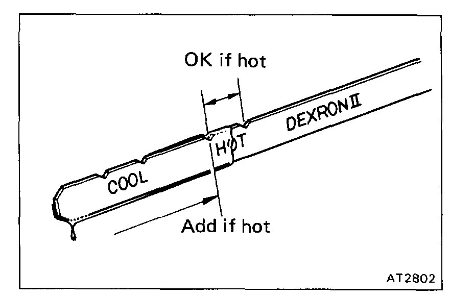

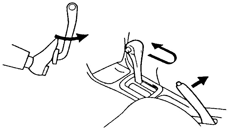

Since you have a transmission dipstick, I would start by adding fluid until it shows full (engine not running). Start the engine and allow it to run for 20 seconds and check it again. Refill it to the full mark, engine off, and start, run it through the gears once, and then follow these directions. Now, I have no idea what all was drained, that is why I am suggesting the above technique. Also, if you reuse your old converter, it will still have fluid in it. Honestly, since you were getting a noise, I would replace it in case there is dirt or metal shavings in it just to be safe. If you do replace it, it will most likely require the full amount of fluid to refill the entire system (dry fill).
Here are the directions for checking. Note that this is based on an Echo. The attached pictures correlate with these directions.
FLUID INSPECTION
1. Check fluid level, as follows:
NOTE:
- Drive the vehicle so that the engine and transaxle are at normal operating temperature.
ATF temperature: 70 - 80°C (158 - 176°F).
- Only use the COOL range on the dipstick as a rough reference when the fluid is replaced or the engine does not run.
a. Park the vehicle on a level surface and set the parking brake.
Picture 1
b. With the engine idling and the brake pedal depressed, shift the shift lever into all positions from the Park (P) to Low (L) position and return to the P position.
c. Pull out the oil level gauge and wipe it clean.
d. Push it back fully into the pipe.
Picture 2
e. Pull it out and check that the fluid level is in the HOT range. If the level is at the low side, add new Automatic Transmission Fluid.
NOTICE: Do not overfill.
2. Check fluid condition. If the fluid smells burnt or is black, replace fluid.
