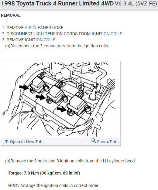

At first instance using SCANTOOL - OBD2 it displayed "RANDOM MISFIRE DETECTED" and all the 6(Six) plugs were replaced and firing was regular with optimum speed attained.

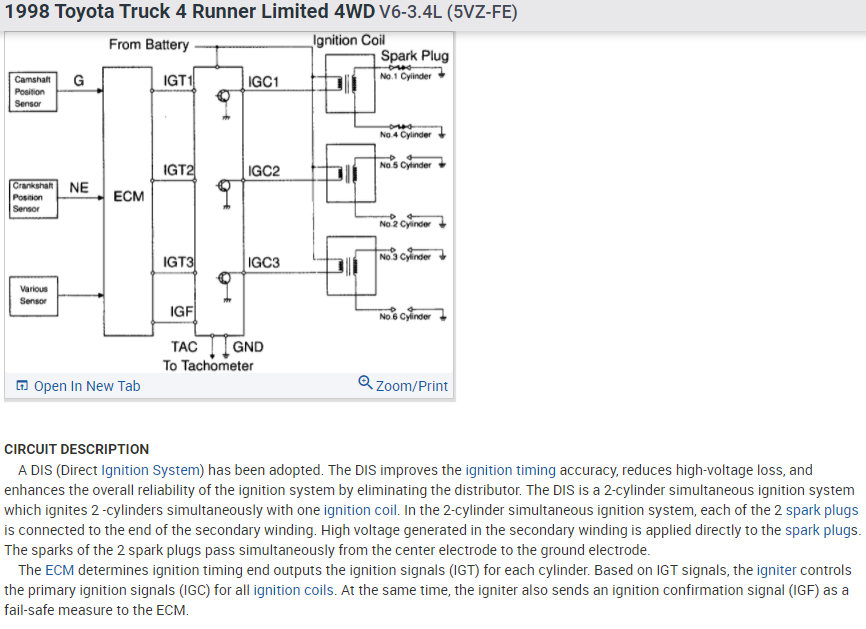

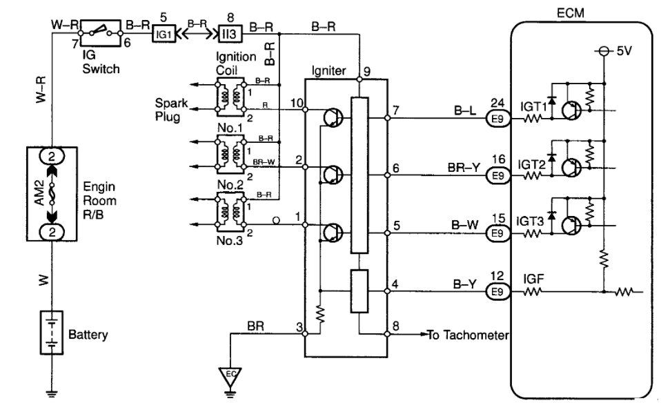

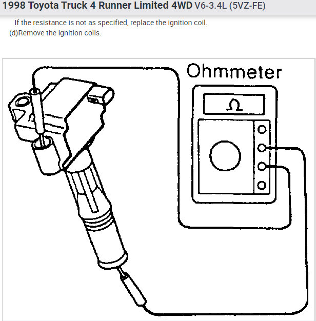

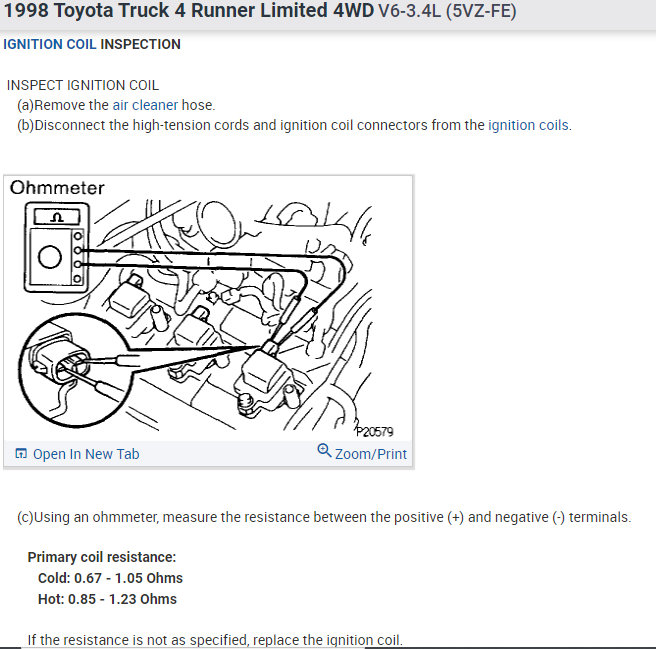

Sometimes random misfire happens when there is an issue with either coils or ignition control module. I have attached ignition coil testing and few other info you might find helpful.
Let me know of any questions.
