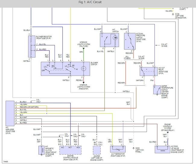

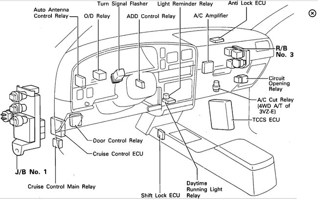

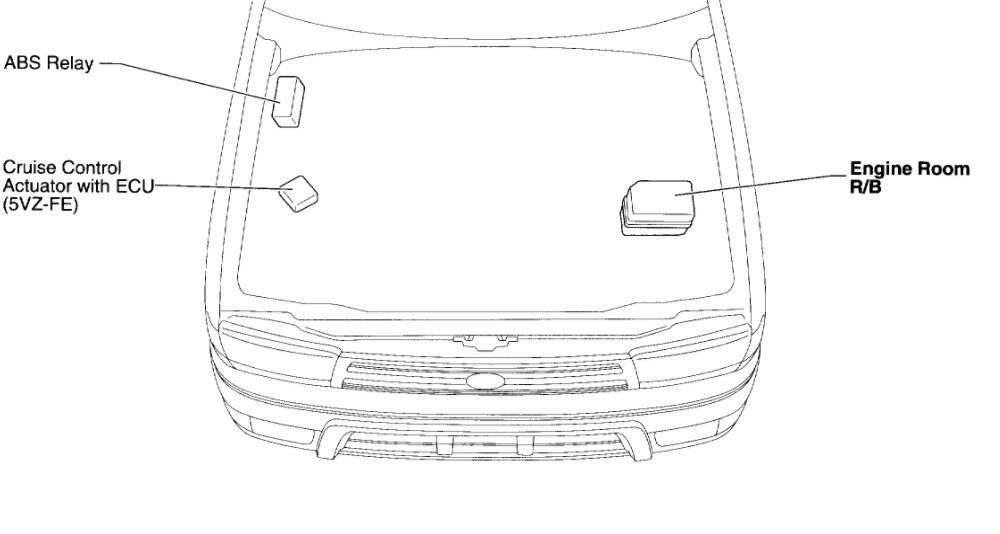

I need to locate the a/c relay in my truck
May 2, 2008 at 2:10 AM
  • 55,325 POSTS
The air conditioner relay is called an AC out relay, here is some guides and some wiring diagrams along with the location of the ring to help you get the problem fixed. (below)
and
Please run some tests and get back to us so we can continue helping you.
(The location of the relay is in the diagrams below along with the air conditioner wiring)
Best, Ken

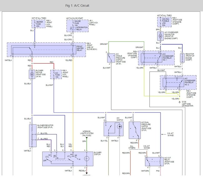

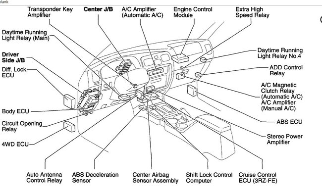

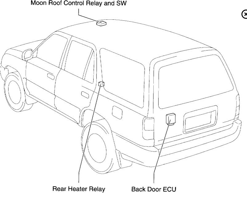

Was told after I had recent work done on my truck that my A/C magnetic relay may be the reason the A/C all of a sudden stopped working. Common issue said mechanic. Says it located under and behind glove compartment, yet when I looked it had no relay located there. So, I need to know where it physically is on my vehicle. Air was working before I had it worked on and now not sure if it just went out based on this common issue or not. Please be precise as as to its location and if able a picture/diagram would be much appreciated.
Jun 27, 2017 at 4:29 AM (Merged)
  • 55,325 POSTS
Here is a complete location finder (below) for the relays and fuses for your car and a guide to help you get the problem fixed.
