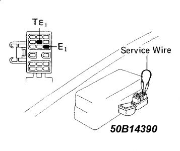

Thank You, Do you know if this vehicle has an
OBD-1 or 2 set up? and if so can you tell me where the test port is loceted and posibly have a code chart. Unfortunately my Haynes manual has nothing on the diagnostic code scenario, what a bummer!!!

Mitchell 1 says the diagnostic connector is behind relay box No 2, but it has no pic to show you, our version in Aus is a bit different, but i think you should find it in the engine bay, either L/H side rear or R/H side rear, it is a small black box with a lid, bridge out terminals as shown in pic, read code as flash codes on check light, I.E 2 long flashes and 4 short flashes is code 24. https://www.2carpros.com/kpages/diagnostic_trouble_codes.htm
https://images.2carpros.com/forum/automotive_pictures/61395_conect_1.jpg
Mark
