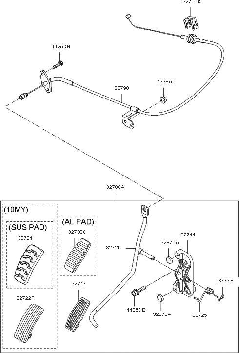

PILOTBILL
  • 87 POSTS
This is the gas pedal setup on our car listed above.

  • 55,412 POSTS
Sorry my bad I never dreamed of a 2009 with a throttle cable. Can I ask if the car has always had this problem or did it just start doing it?

  • 55,412 POSTS
Please remove the throttle cable from the throttle bore and move it by hand it should move with little effort. Then buy a new throttle cable and install it or try to lube the cable you have with wd40, also lube the pedal pivots this should take care of the problem.
