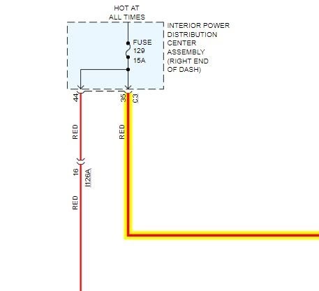

After having a new battery installation. My radio/climate controls are black or off.
Nov 23, 2018 at 11:01 AM
  • 110,241 POSTS
The first thing I want you to check is fuse 129. It is a 15 amp fuse located at the right end of the dash. I attached a picture of a wiring schematic. This is the fuse that powers the unit. See if it was blown.
Let me know what you find.
