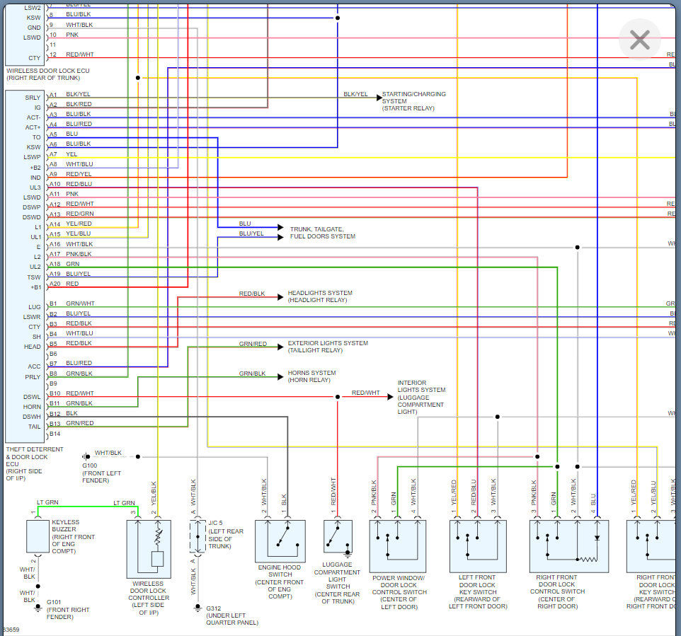

How can I break my ignition switch? I got it to work fine without the security going off, but now someone hit the reset adjustment switch and it will not start and will not quit locking the doors. How do I disassemble the the system?
Sep 21, 2016 at 3:45 PM
Unfortunately there is no easy way to disable this system. The most common way to do this is get an engine controller that does not require the approval of the theft system.
Whether there is a company that makes one for this vehicle is something you will have to research but that is the most common way people bypass this system.
https://www.2carpros.com/articles/how-to-reset-a-security-system

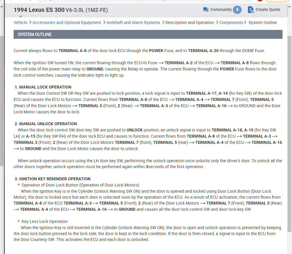

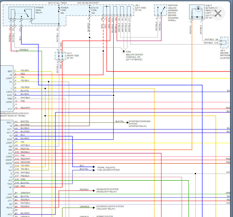

Below is the info and wiring diagrams on this system in the event you need them. Please run through this material and let us know what you find.
Thanks
