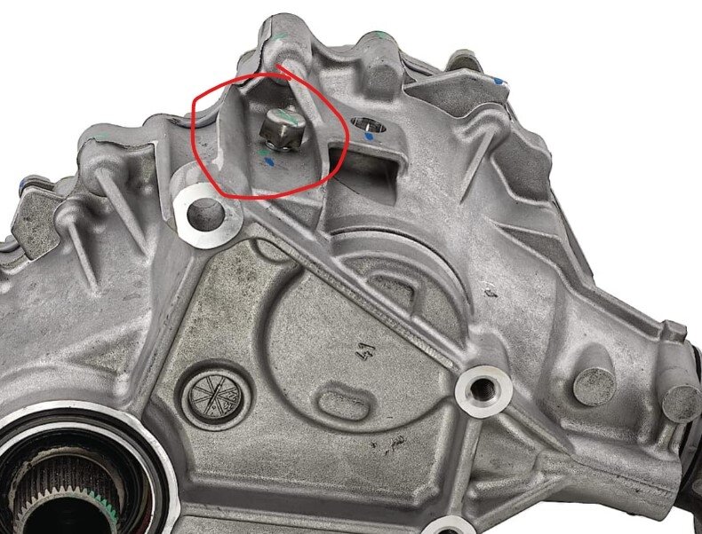

I tightened the nut to 142Nm and I no longer have the clunking noise when shifting. It's been a few days now so I'm hoping for the best. By the way, the reason I had this problem was because the jiggle valve on the PTU was clogged which created a leak. I removed the PTU, cleaned it out, replaced all the seals,and added a drain plug. Not sure why Ford would make this a non-serviceable part. Anyway thank you for your information, it was very useful to me.

I believe he was referring to the vent on top of the unit. It can get blocked with dirt and crud and then when the PTU gets warm the pressure forces oil to leak past the seals. It is a pressed in part on top of the unit, to clean it is simple, just use a wire brush around it and be sure the cap can freely move.
