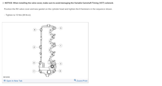

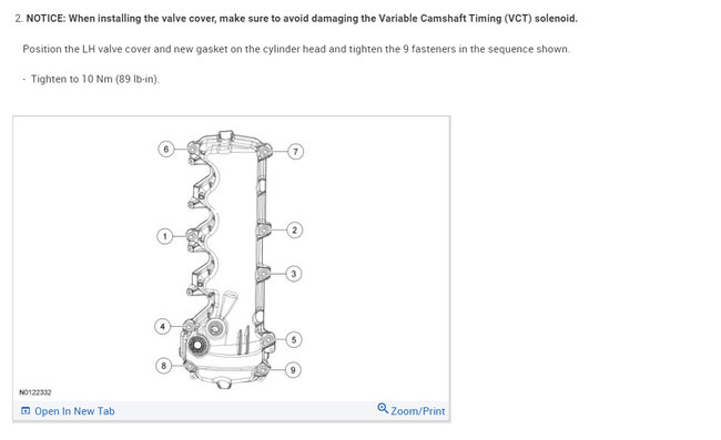

Valve cover Torque specs needed
2012 LINCOLN NAVIGATOR
96,000 MILES • V6 • 2WD • AUTOMATIC
MSCOWN
What are the torque specs for the valve cover bolts on the vehicle listed above?
Jun 20, 2022 at 3:02 AM
AL514
  • 5,639 POSTS
Hello, we don't have a V6 listed for that year, but most valve cover bolts are 89lbs-in. Check out the diagrams (Below). Please let us know if you need anything else to get the problem fixed.
