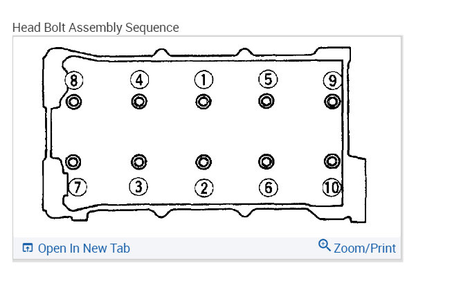

What are the torque specs for cylinder head and the valve lashing for all valves?
2002 MAZDA 5
1,800,000 MILES • 2.0L • 4 CYL
JASONBURMS
Need to know torque specs for cylinder head and the valve lashing for all valves, please.
May 12, 2023 at 12:14 PM
  • 55,423 POSTS
Sure, here you go.
Cylinder Head Bolts .................... 76-81 Nm (56-60 ft lbs)
Valve clearance
IN .................... 0.18 - 0.24 mm (0.0071 - 0.0094 inch) (0.21 ± 0.03 mm (0.0083 ± 0.0011 inch))
EX .................... 0.28 - 0.34 mm (0.0111 - 0.0133 inch) (0.31 ± 0.03 mm (0.0122 ± 0.0012 inch))
Check out the images (below). Please let us know if you need anything else to get the problem fixed.
