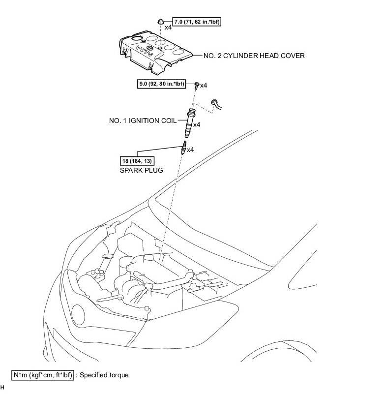

I need the procedure and torque specs for the spark plugs and ignition coil and cover the car listed above.

Hello.
Hope the following link and diagram help in your repairs, Please keep us up to date on your repair.
https://www.2carpros.com/articles/how-to-change-spark-plugs
Thanks for using 2CarPros.
Dave H

Should I put dielectric grease on the sparkplugs?

I always add a little dielectric grease to the top of the sparkplugs to aid removing and not damaging the coils in the future when needing to remove them.
Hope this helps with your repair. Please keep us updated on your repair outcome and do not hesitate to contact us again for further information or assistance.
Dave H
