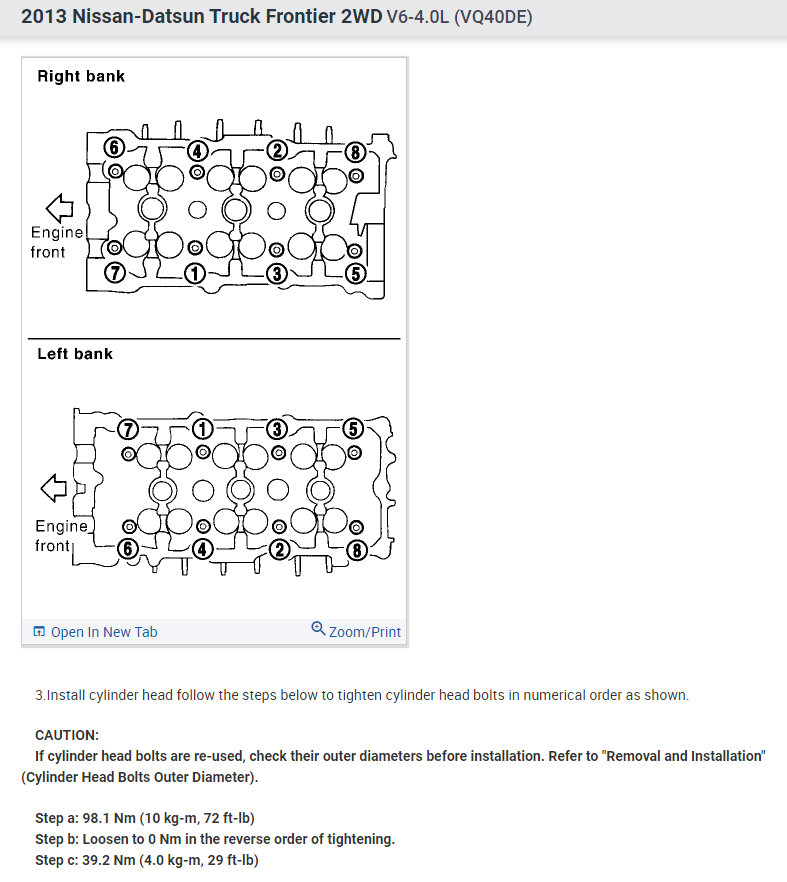

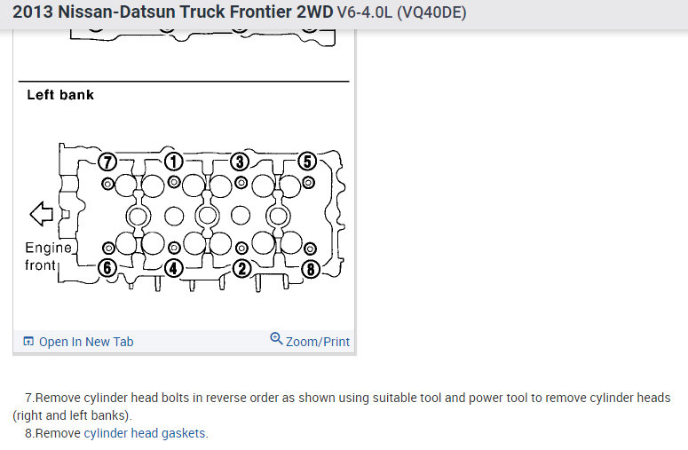

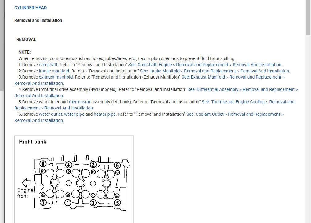

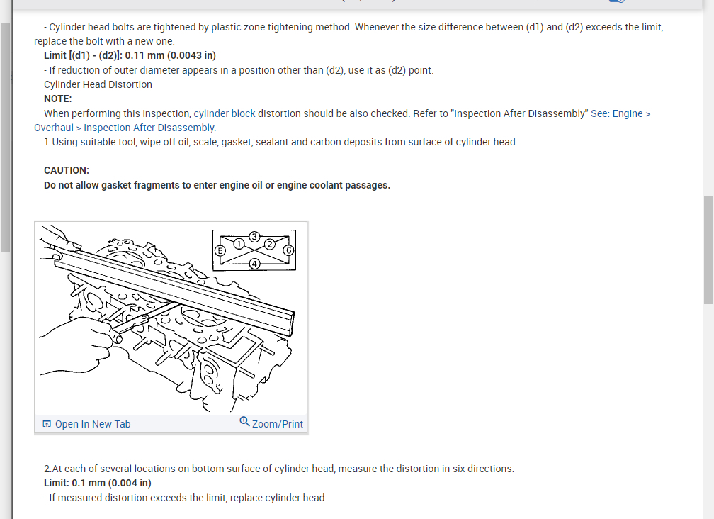

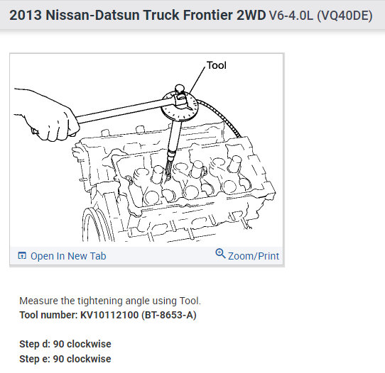

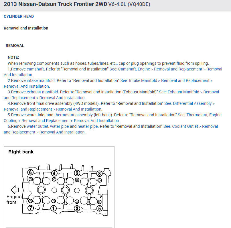

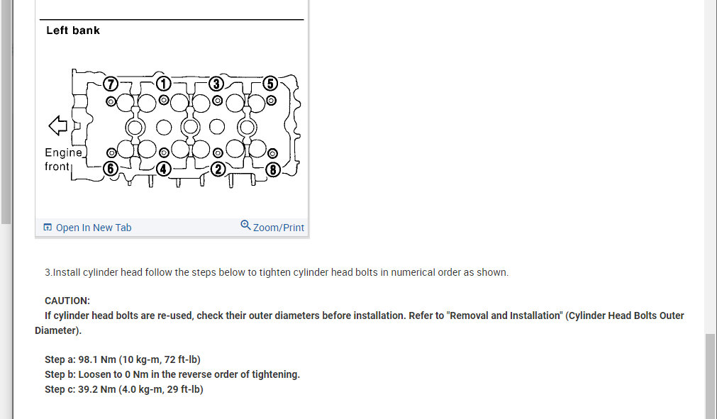

Can I get the cylinder head torque specifications?
2013 NISSAN FRONTIER
60,000 MILES • 4.0L • V6 • 2WD • AUTOMATIC
SALOMONS

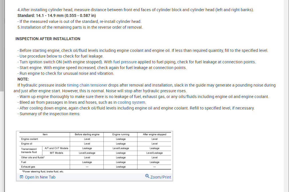

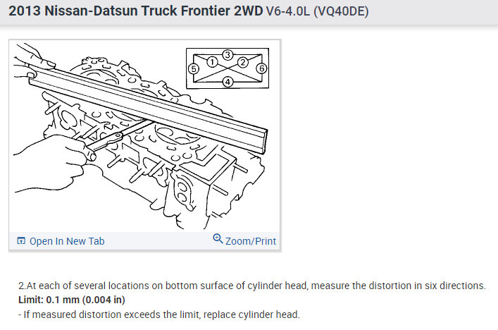

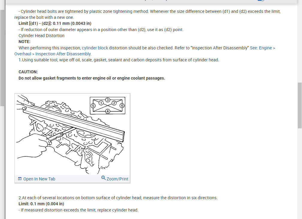

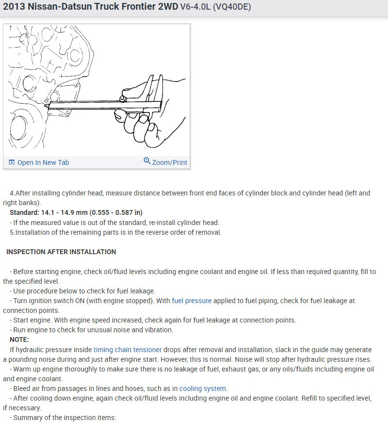

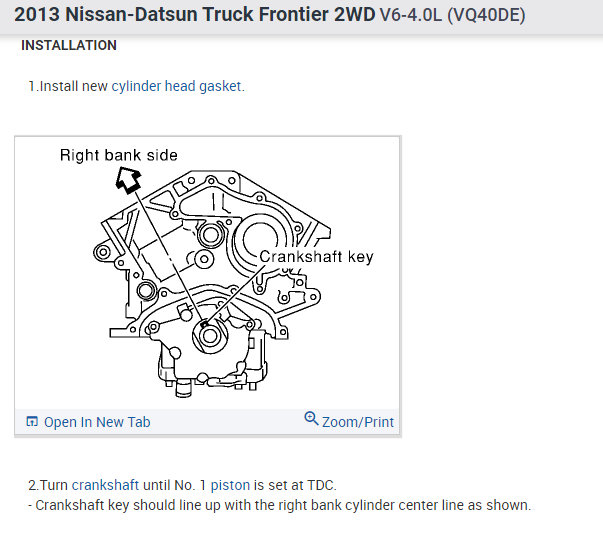

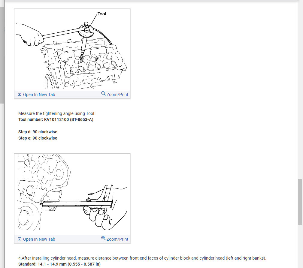

Need Torque specs and sequence after replacing head gasket.
Oct 1, 2021 at 6:39 AM
I am attaching the manual for the entire process of removing an installing the head.
Here is a guide that will help with this for those that may need it:
https://www.2carpros.com/articles/how-a-cylinder-head-works
Please see all the info attached below. Let us know if you have other questions. Thanks
Oct 1, 2021 at 7:46 AM
SQM
  • 6,383 POSTS
I have attached the torque specifications and sequence, as well as the procedure (look below).
