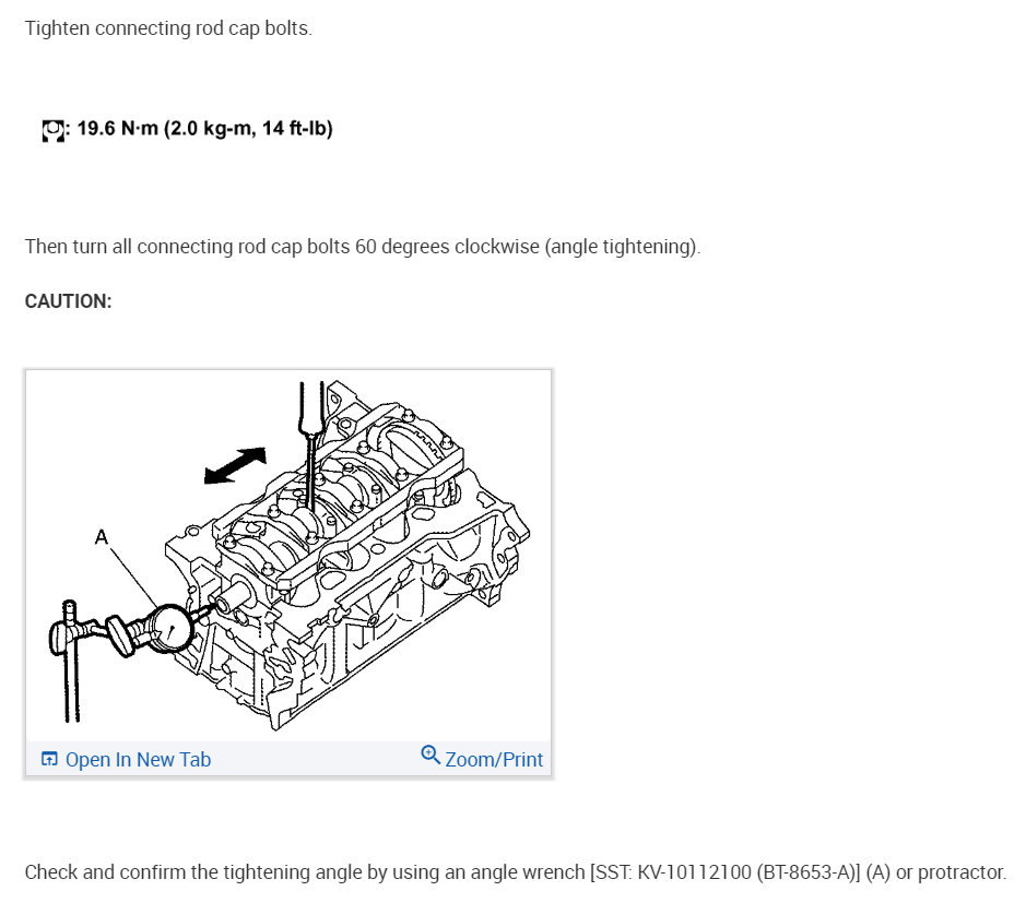

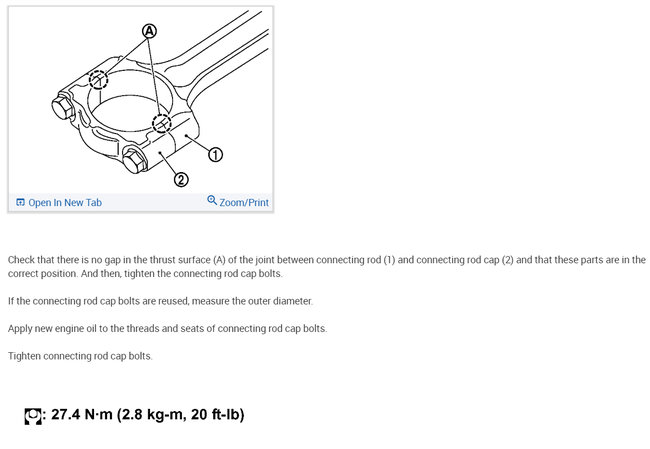

Hi. I’m looking for torque settings for big end bearing caps please.

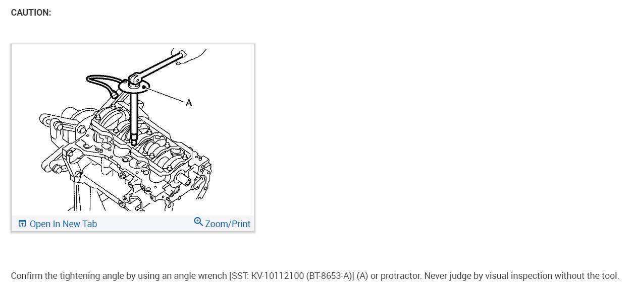

Some are torque to yield so be ready for that. here is a video that shows how to use a torque wrench correctly and the engine torque specs and directions below:
https://youtu.be/juOClONIWeY
For the Nissan E16 engine, the big end (connecting rod) bearing cap bolt torque specifications are as follows:
Torque setting: 24-29 ft-lbs (32-39 Nm)
