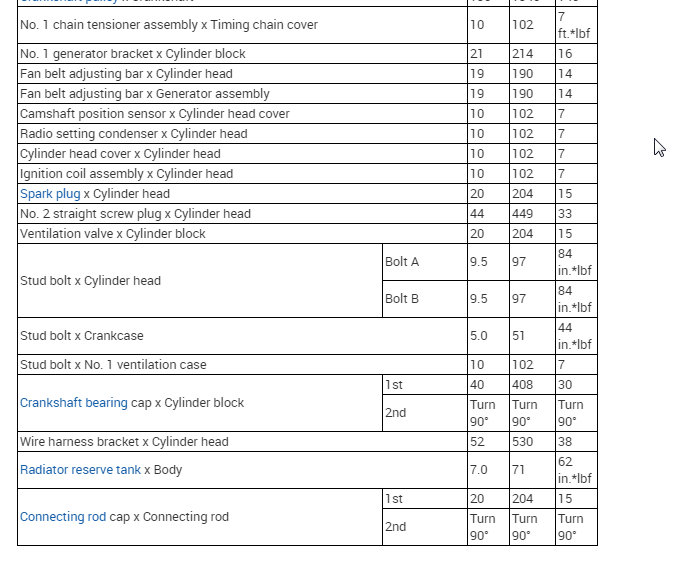

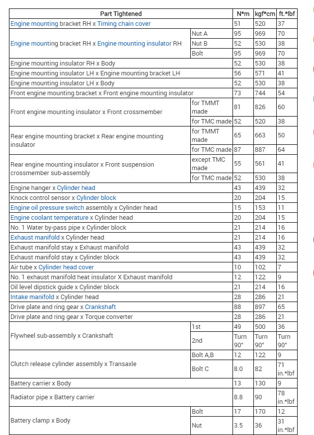

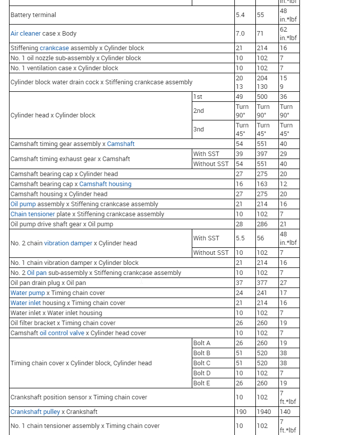

Need the torque settings on a 1NR0180134 Toyota Corolla Engine.
Feb 7, 2020 at 11:24 PM
Not sure if you need specific torque settings for the engine so I included all the torque specs listed under the engine. Let me know if you need something specific and I can get that as well. Thanks
