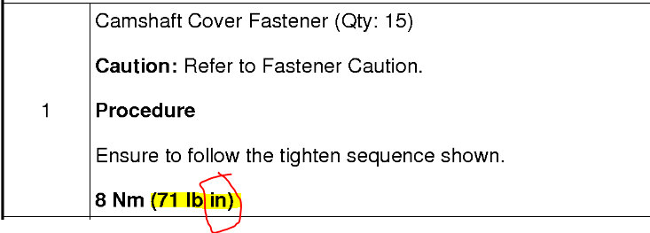

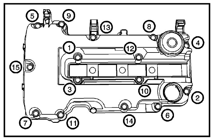

Need a diagram of the torque sequence for the valve cover/valve cover gasket.
Apr 18, 2023 at 6:24 AM
  • 110,248 POSTS
I never realized how many bolts this uses. LOL
As far as the torque sequence, see pic 1 below. Pic 2 provides the torque specifications. Please note that the torque is in inch-pounds and not foot-pounds.
