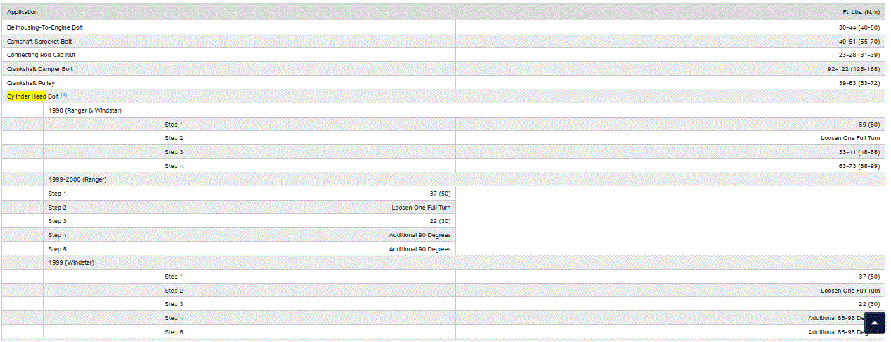

Torque on head bolts
1999 FORD RANGER
223,000 MILES • 3.0L • 6 CYL • 4WD
DEJEDJ0480
don't know ft lbs on bolts.
Dec 22, 2018 at 12:17 PM
HARRY P
  • 2,292 POSTS
Check out the image below. This is the information, as provided by Ford to Prodemand. Hope it's clear enough for you. Let me know if there's anything else that you need, and feel free to come back to 2carpros anytime.
