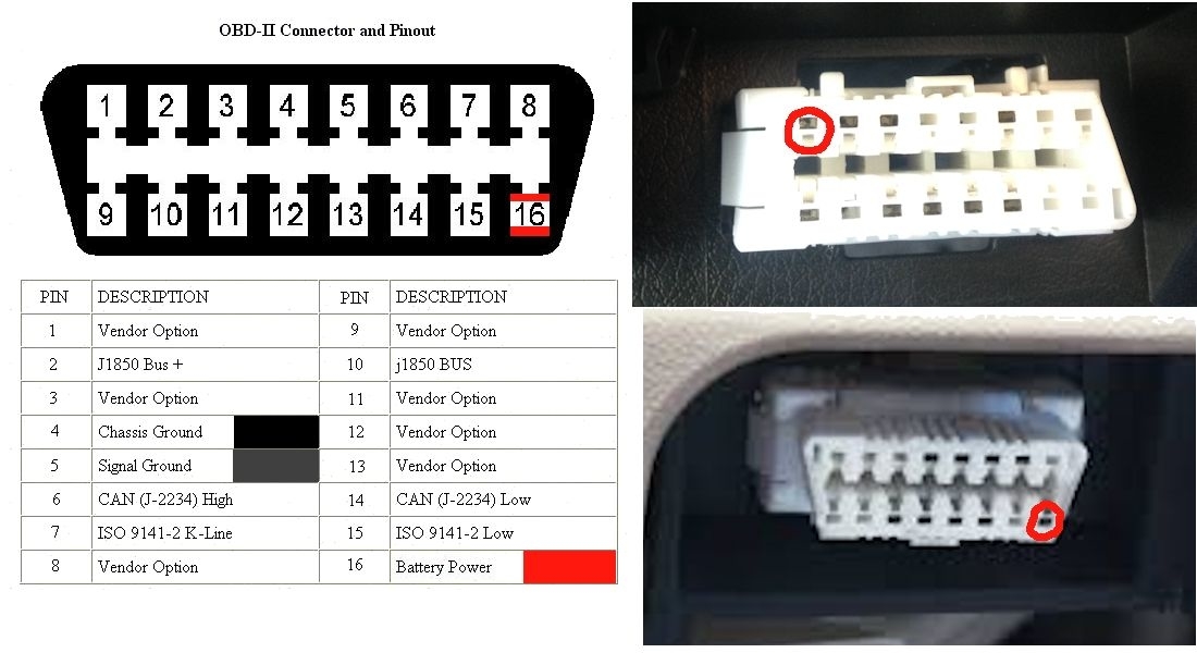

If you want to pull the codes yourself it is possible to do, you need a simple piece of wire and a pen and paper.
First, find the DLC connector, it will be under the dash with a cover over it and look like the first image below. It can mounted right side up (wide section up) or upside down as it likely is in your truck.
Take the piece of wire, strip the ends and twist them tight. (or cheat and use a small paperclip bent into a U shape) You want to connect the number 8 pin (transfer case module) and the number 4 pin (ground).
Number 8 is the pin directly opposite the pin with the red circle. Pin 4 is in the same row just count backwards from pin 8.
Now for the hard part. Turn on the key and you should see the same check light you are seeing now start flashing.
As it flashes it will tell you any codes stored.
To read the codes you count the flashes
Flash pause Flash Flash would be code 12 and indicates it is now in diagnostic mode.
That will flash three times.
Flash pause flash flash, long pause flash pause flash flash, long pause flash pause flash flash.
Now start counting, each code will flash 3 times. So if you see
flash flash pause flash flash flash flash, long pause flash flash pause flash flash flash flash, long pause flash flash pause flash flash flash flash.
You would read that as Code 24 - Rear speed sensor open or shorted to ground.
When it finishes flashing any stored codes it will begin the cycle again starting with 12. When you see 12 again you can turn off the key and stop counting.
