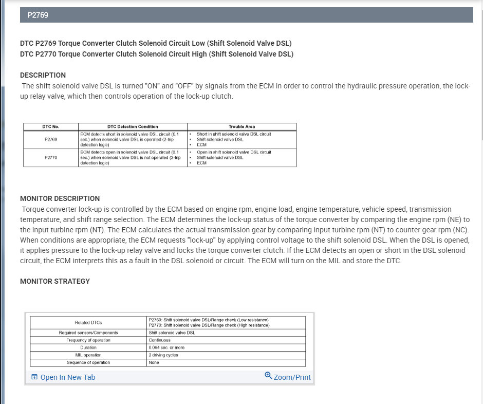

I was driving and the check engine light is on. when I was going faster than 70 km/h my car would rev and the tires felt as if they weren't connected to the gas. Turning off the car and then on again would fix the issue, but it would arise again whenever I pressed on the brakes.

The code is P2769.

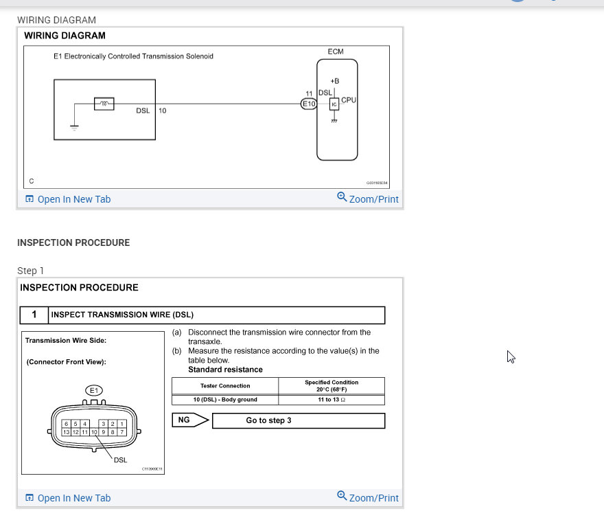

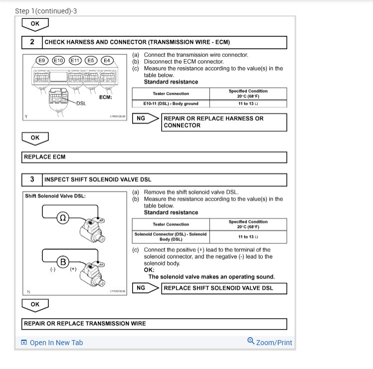

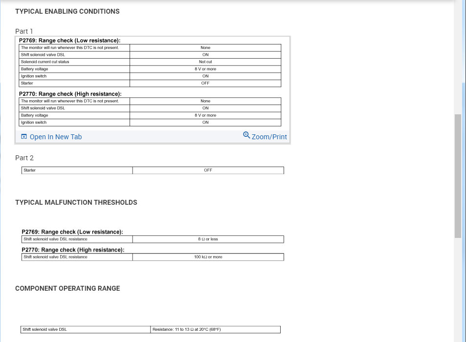

I attached the testing just for your review. However, this is normally one of two things. Either the torque converter shift solenoid is the issue or the wiring to it.
If the issue is the solenoid then the part looks to be about $200 and the labor will vary depending on the amount of diagnostic time they need to figure it out plus what their door rate is so it is hard to give you an estimate on something like this. If the vehicle drives, then I would just take it slow and back roads if needed but you are not going to do any more damage to the transmission with this issue. It just won't shift to overdrive.
