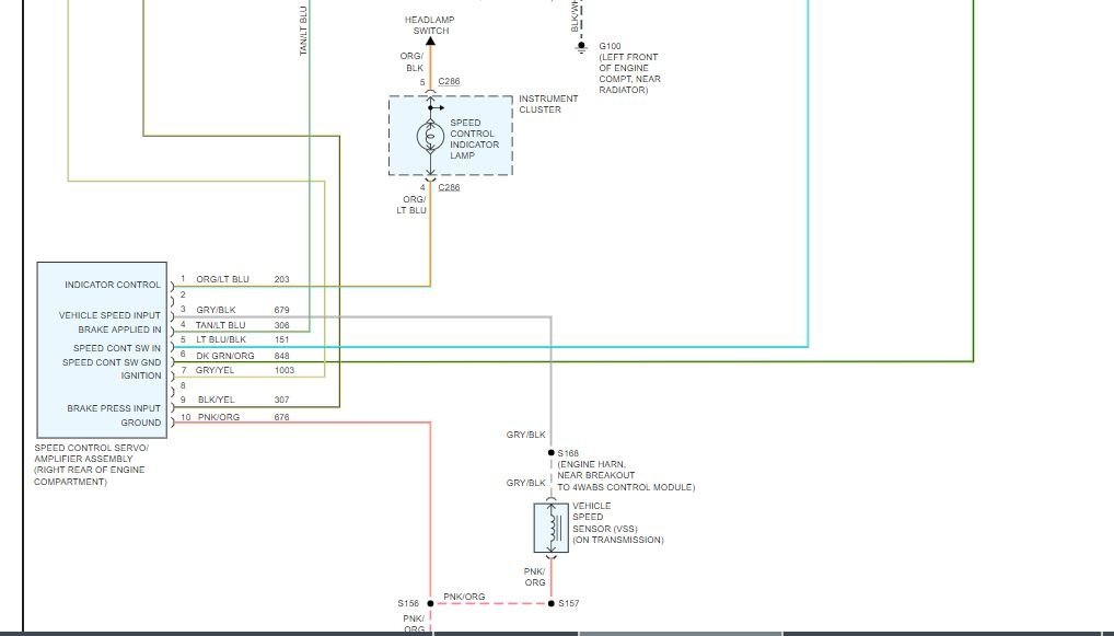

Only thing else I checked is I have a scan gauge which allows me to see what speed the computer sees, and its not seeing vehicle speed.
My SUV listed above has a cable to run the speedometer. so speedometer works, but computer is not seeing any MPH.

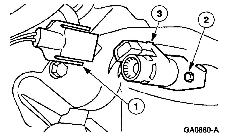

Good morning,
Does the speedometer work on the dash and show speed?
If the scan tool is not showing speed, then a good chance there is no signal from the vehicle speed sensor itself.
I attached the description for you below.
There is no cable for the speedometer. It has been electronic for many years.
DESCRIPTION

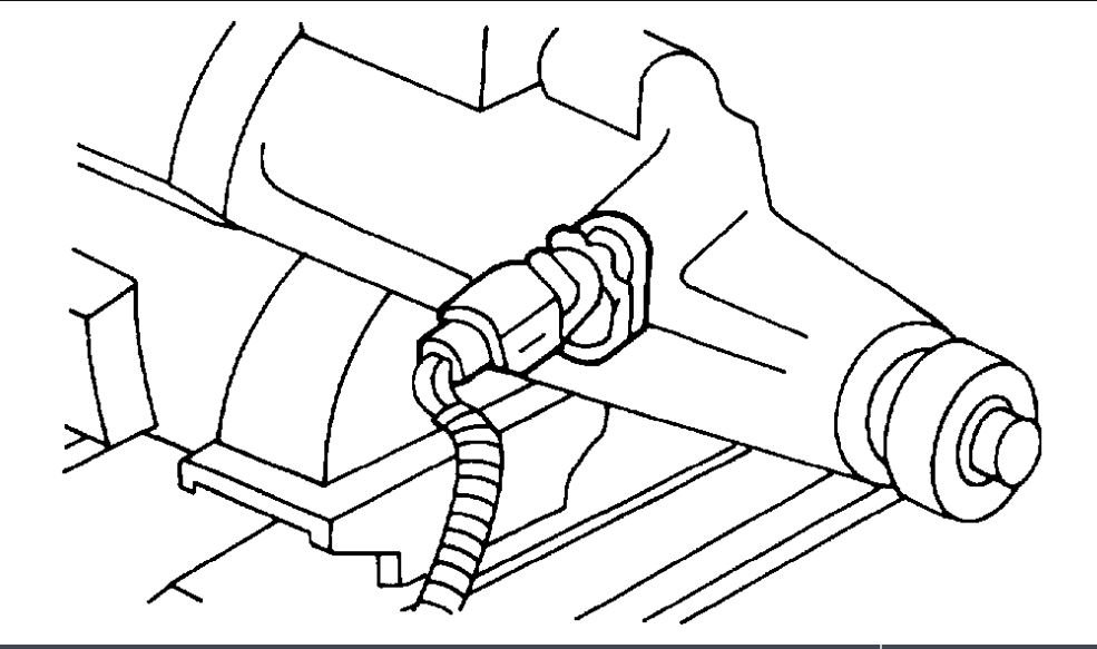

The Vehicle Speed Sensor (VSS) is a magnetic pickup that sends the Powertrain Control Module (PCM) vehicle speed information.
The VSS sensor is mounted externally on the left-side of the transmission extension housing.
The PCM uses VSS information to help determine Electronic Pressure Control (EPC), shift scheduling and Torque Converter Clutch (TCC) operation.

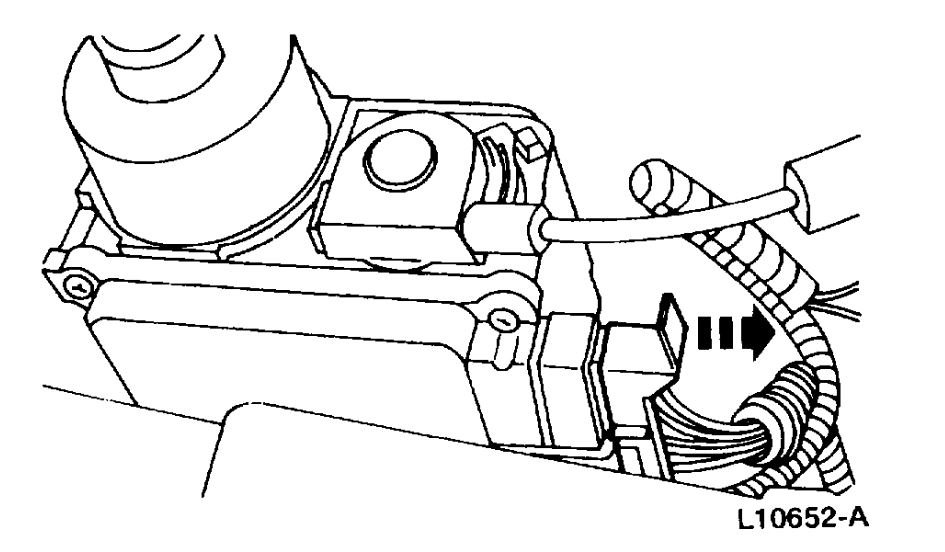

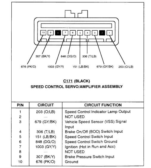

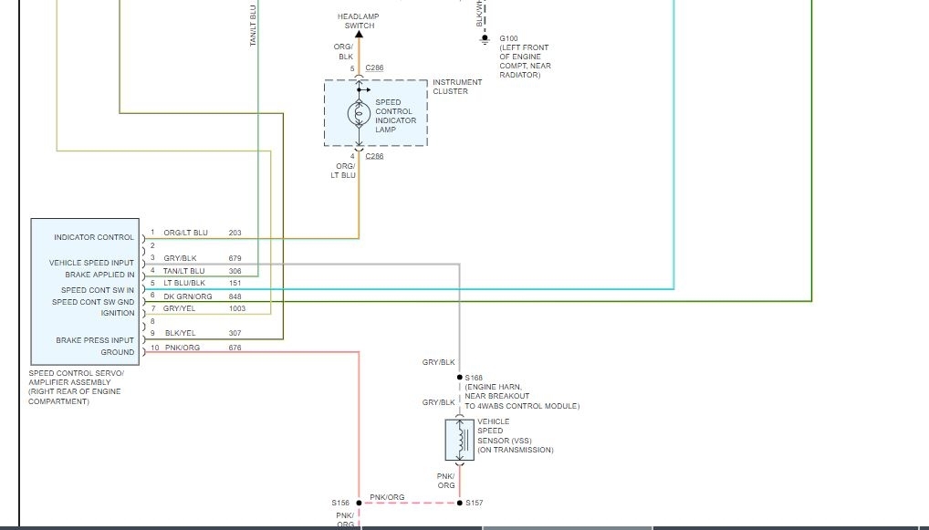

Okay, do you have a scan tool that can read the cruise control system and see live data?
You will need this to help find the issue. It could be the module but needs to be confirmed.
It is located on the front frame rail.

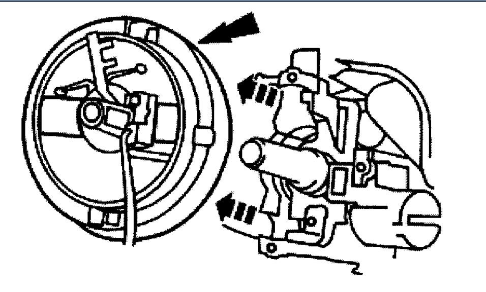

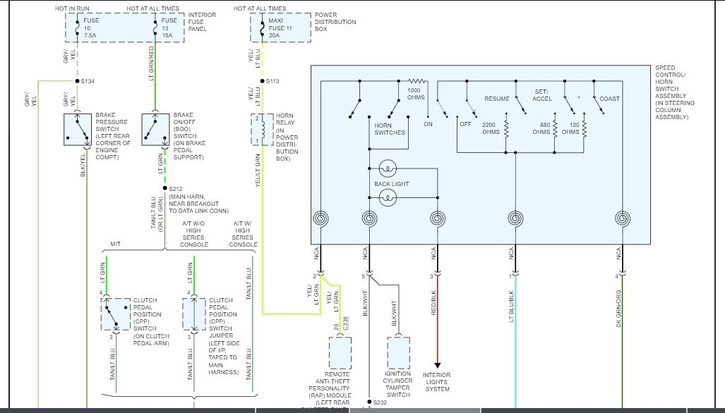

Jun 11, 2020 at 6:36 AM

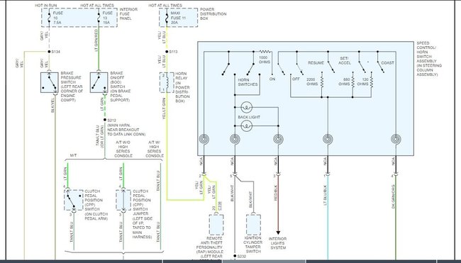

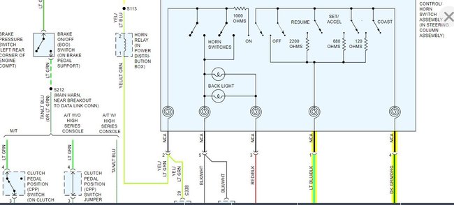

Okay, I attached a close up of the switch. It goes through the clock spring on the steering wheel. You need to verify power at the feed to the switch and the output coming out of it.
These tests need to be done at the clock spring itself.
