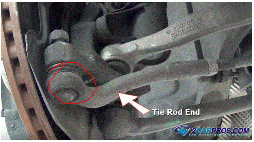

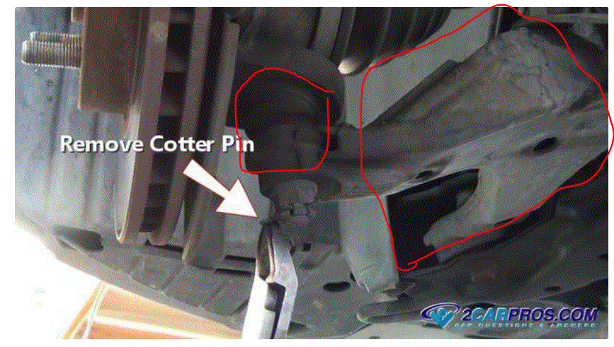

Feels like my tires are wobbling when driving at low speeds. I also know my sway bar links are stuffed.

If you feel a wobbling, first make sure there is no damage to the tires. Check for shifted belts or a bulge in the tire.
If that is good, I need to understand what you mean by the stabilizer being stuffed. Are they broken? Also, when you feel the wobbling, is it a left to right feeling or up and down? Have you checked steering components including ball joints, tie-rods, and joints in the steering components?

It's a side-to-side wobble. I changed my sway bar links yesterday and that helped a bit. Also, one of my back tires has a chunk out of it.

Check to make sure the ball joints and tie rods are in good condition. I attached pics below of what you are looking for.
